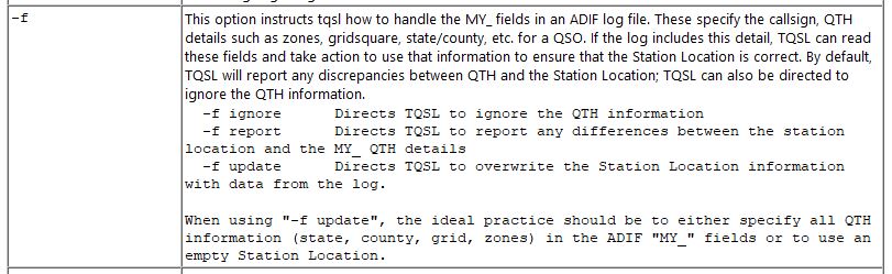

There is an option [ ] "Send My Station Updated Data to LoTW ("-f update param)
In the Manual Page 118, I do not see What it is for, or What Data it sends.?
Can somebody explain.?
Many Thanks

Dave,
That command line item is a function of the TQSL APP on your computer. I opened my TQSL and went to TQSL Help and found the detailed explanation for the Command Line Interface values.
The -f command in clipped below.
Hope this helps explain.

Hi Nolan,
Many Thanks for the response
Didn't think to look at TQSL, never touch it unless adding Cert or Location.
Maybe a "Clue" could be added.?
Instead of: ("-f update param) maybe ("-f update param TQSL)
Thanks... Dave
Thanks... Dave
