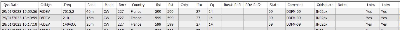

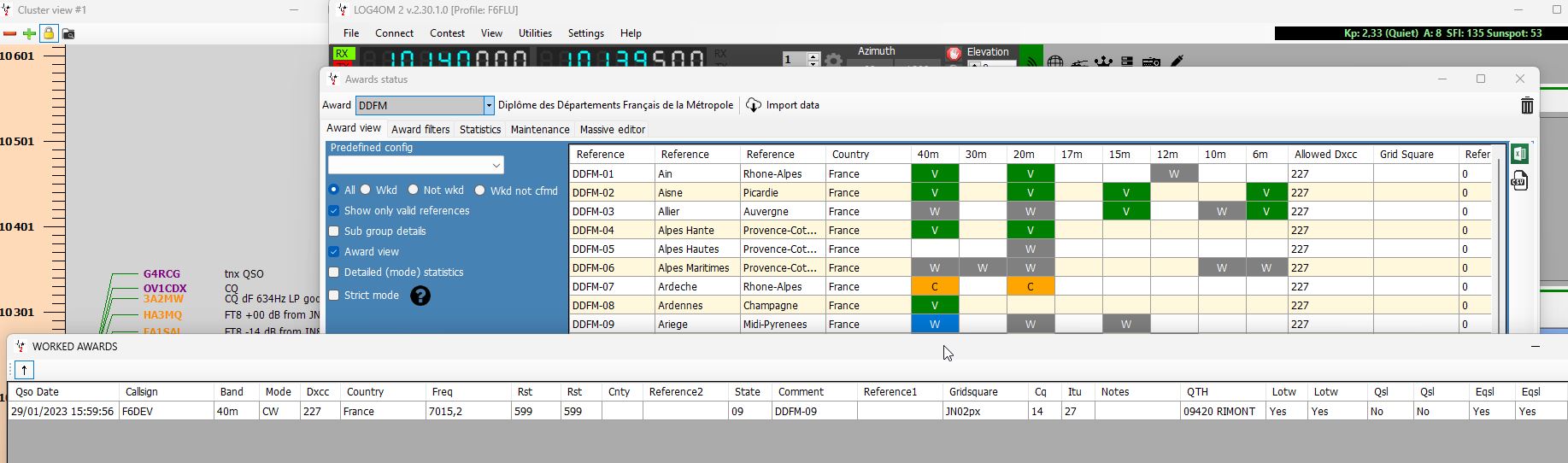

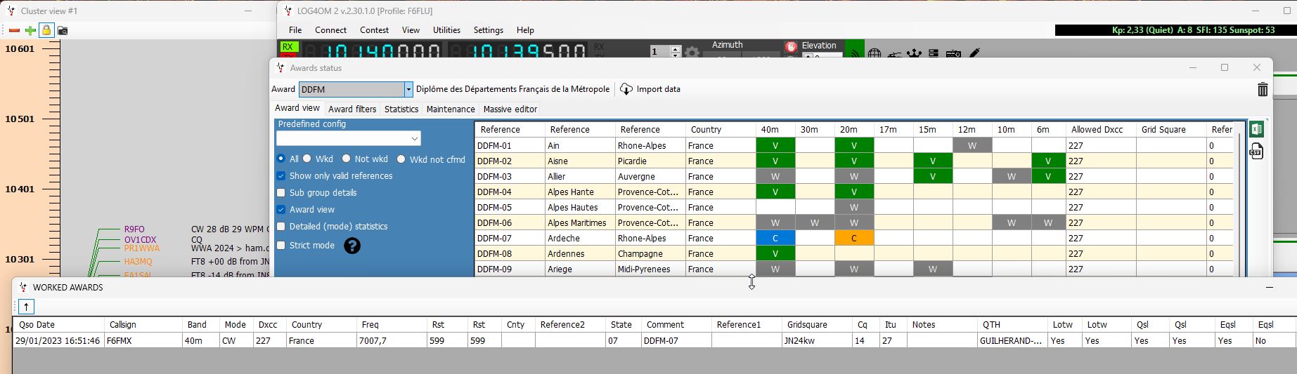

Hello, something I don't understand in the DDFM award
If I look in the DDFM-07 I have "C" because I had the QSL confirmation paper
2024-01-31 10_12_54.jpg (160.91 KiB) Viewed 2515 times

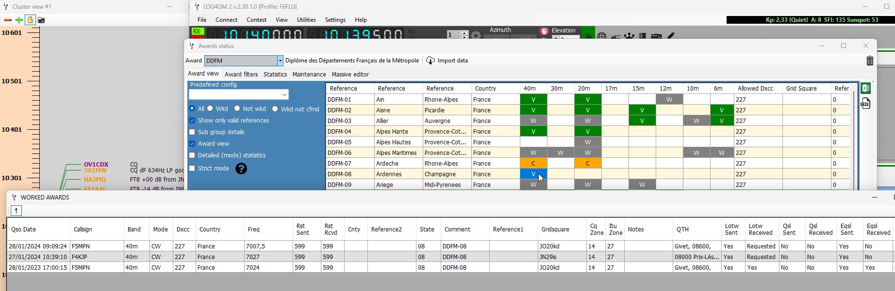

If I look in the DDFM-08 I have "V" because I have validation by LOTW and not by the paper QSL
2024-01-31 09_59_27.jpg (183.46 KiB) Viewed 2515 times
But
If I look at the DDFM-09 I get “W” even though the QSO is validated by LOTW
2024-01-31 10_00_38.jpg (157.64 KiB) Viewed 2515 times
What must be done for Log4OM to take this LOTW into account?

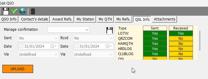

2024-01-31 10_02_37.jpg (32.28 KiB) Viewed 2514 times
2024-01-31 09_55_02.jpg (24.33 KiB) Viewed 2514 times
2024-01-31 09_54_41.jpg (40.11 KiB) Viewed 2514 times

for information
I have dozens of errors like this
The correction is simply to take QSO by QSO and re-create the DDFM in the "Award Refs" field.
and then everything is OK
So it's just to give the information to the developers that there is a problem, it's not serious but what is important is that Log4OM does not report an anomaly, it would be good if we could fix a utility to check this consistency :-)
