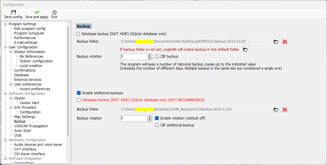

Hi, Terry. I believe I am using Log4OM's built-in backup system. Sorry if I didn't make that clear. See the attachment. My batch file is just a general PC-wide backup that copies new/changed data to an external drive.
If this is sufficient, great. I haven't been checking the "Database backup" box, which would mean I'd have to rebuild it from the ADIF backup. I can certainly check that box. I should probably check the Zip backup box, too, as it would save space.
- Log4OMbackup.jpg (51.93 KiB) Viewed 1573 times

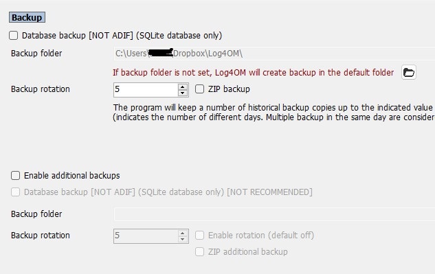

Pete,
Seems like you have backups of backups and possibly more backups.
Backups are good, don't get me wrong, but don't overthink it.
I have my main backup going to a folder on my SSD and I have a secondary backup (copy of the main backup) going to my Dropbox folder. Having the adi and json backups are all that are necessary and make it easy to restore should such be needed.
Personally, I don't feel the need to us the zip version or the sqlite version.
Image below is my arrangement and is what I started using many long years ago when I also moved from V1 to V2.
I yellowed out my 'username', but you should get the drift.
- log4om2_backup.png (42.47 KiB) Viewed 1568 times
