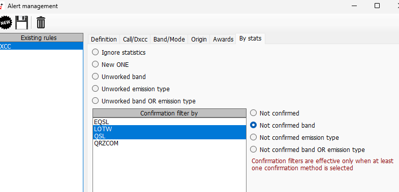

"not confirmed band" in the Alert Management is not allowing new dxcc on band when a non-confirmed QSO is already there.
In Test#1 below we do BA5CJ 80M CW with no prior 80M QSO in log. It works and we get alert audio and email.
In Test#2 we add BA5CJ 80M CW to log unconfirmed -- then spot it and it does not alert as expected.
In Test#3 we then spot BA5DX -- but it does not alert in cluster, audio, or email like it should since it's a new call on China and 80M China is not confirmed

Cluster alert band not confirmed is broken

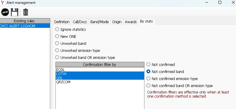

Hi Mike, i just did that:
Set the alert to spot "non confirmed bands" in the last tab, confirmation type set to "QSL" (only QSL selected in the list) (i don't have any confirmation on 80m for china in test database).
No other settings on that.
Started a localhost cluster server from log4om and connected log4om cluster to this one (to avoid having noise due to real incoming spots). now log4om is connected to his own cluster server that is not receiving any spot from outside so i don't have any other cluster spot during tests.
1) Added a spot simulation to BA5CJ on 80m CW. Alert triggered correctly
2) Added BA5CJ to log and sent a new spot to BA5CJ on 80m CW. The spot WAS NOT ALERTED as it was PREVIOUSLY SPOTTED in the same session and log4om doesn't send duplicate alerts (there is a time range). The alert is not sent due to "duplicate prevention" not because it has been WORKED (we requested the non CONFIRMED bands so this qso is not confirmed by definition), if you close log4om with BA5CJ on the log, unconfirmed, on new start it will be notified again...
3) Added a spot to BA5DX on 80M cw and log4om correctly alerted it...
So according to my tests everything is working as expected...

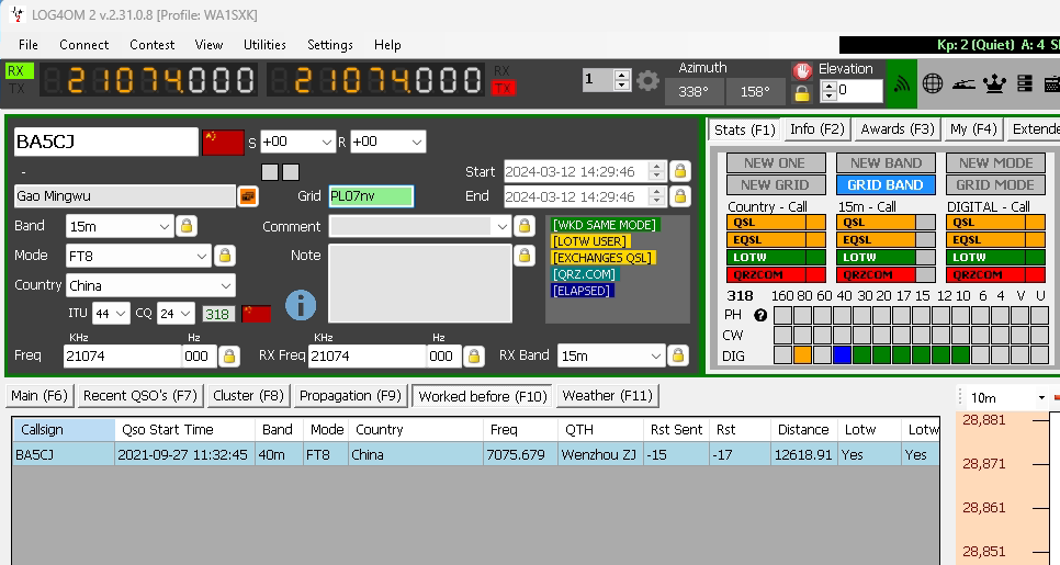

Re: Cluster alert band not confirmed is broken
What's not working now is the email notification....not getting one.
Just had another spot where I had 20M confirmed but the spot was on 10M and got the audio alert -- but no email.
Mike,w9mdb wrote: 12 Mar 2024, 12:13 What's not working now is the email notification....not getting one.
I just did a spot simulation test (after I enabled the e-mail alert as I don't often use) and it worked FB for my test.
Simple simulation on 40m CW.
BA5DX is worked 80M but not confirmed.
BA5CJ is worked only on 40M confirmed.
6M has nothing worked
80M has a worked which is BA5DX -- not BA5CJ so not worked B4 on 80M but was worked on 40M.
Here is a 6M spot which does give the audio alert and the email. 80M spot debug below.

And now the 80M spot which does not trigger audio or email -- it's missing the CLUSTERALERT line....
[Simulation] DX de WA1SXK: 3053.0 BA5CJ FT8 1417Z
2024-03-12 14:17:35.0450 DEBUG: [dje_zKZZWQMU795TF58DYVVJLGFUJPHKK4RDPVS_ejd][MoveNext] : Performing QSO search on callsign BA5CJ
2024-03-12 14:17:35.0490 DEBUG: [Countries][SearchCallsign] : Performing Search Callsign on call BA5CJ on date 2024-03-12 2:17:35 PM
2024-03-12 14:17:35.0600 DEBUG: [dje_zKZZWQMU795TF58DYVVJLGFUJPHKK4RDPVS_ejd][MoveNext] : No Clublog CQ ZONE found for BA5CJ
2024-03-12 14:17:35.0660 DEBUG: [dje_zKZZWQMU795TF58DYVVJLGFUJPHKK4RDPVS_ejd][MoveNext] : Searching clublog exceptions
2024-03-12 14:17:35.0680 TRACE: [dje_zKZZWQMU795TF58DYVVJLGFUJPHKK4RDPVS_ejd][MoveNext] : No Clublog exceptions found for BA5CJ
2024-03-12 14:17:35.0680 DEBUG: [dje_zKZZWQMU795TF58DYVVJLGFUJPHKK4RDPVS_ejd][MoveNext] : LOTW user identified
2024-03-12 14:17:35.0690 DEBUG: * [dje_zKZZWQMU795TF58DYVVJLGFUJPHKK4RDPVS_ejd][MoveNext][23 ms] : QSO search on callsign BA5CJ completed
2024-03-12 14:17:35.0690 DEBUG: * [Countries][SearchCallsign][19 ms] : Performing Search Callsign on call BA5CJ on date 2024-03-12 2:17:35 PM
2024-03-12 14:17:35.0789 TRACE: [ProgramStorage][GetFlag] : Flag CHN identified.
2024-03-12 14:17:35.0809 DEBUG: [Countries][SearchCallsign] : Performing Search Callsign on call WA1SXK on date 2024-03-12 2:17:35 PM
2024-03-12 14:17:35.0929 DEBUG: [dje_z7JFPYWMUBVHCYV49Y9D59LS7W7VA_ejd][MoveNext] : SPOT mode overriden to FT8
2024-03-12 14:17:35.1068 TRACE: [dje_z7JFPYWMUBVHCYV49Y9D59LS7W7VA_ejd][MoveNext] : Cluster ranking search: DXCC 318 China -> 282
2024-03-12 14:17:35.1383 TRACE: [dje_zUGSCJ5V5X3RPAY84WDGFS_ejd][MoveNext] : Executing planned scheduler...
2024-03-12 14:17:35.1383 TRACE: [LogWriter][DumpProcess] : ## DUMP MODULES ##
2024-03-12 14:17:35.1393 TRACE: [LogWriter][DumpProcess] : ## DUMP ##SearchCallsign Countries 1
2024-03-12 14:17:35.1403 TRACE: [dje_zNQN2PU7B_ejd][dje_z3Y7A6PDYKQMBUAWJNBLQF8FSJZFHU3E2C2_ejd] : ################# START Update solar image from scheduler
2024-03-12 14:17:35.1403 TRACE: [MapManagement][MakeSunImage] : Painting sun image...
2024-03-12 14:17:35.7949 TRACE: [MapManagement][CreateBitmapWithPosition] : Creating bitmap with station position

just to make something clear:
the alert is NOT reporting/checking if a single callsign is worked or not (except for specific rules involving specific calls). It works by DXCC for the function you selected, so callsign is not relevant.
if an alert has been triggered the alert will not be triggered again. Here the callsign is relevant, as the "non flooding" function works by call also.
I'm about to release a new alpha version with some more log traces.
Tested with 2.31.1.0
ZA/IW2JOP is validated on 10M/12M
ZA5G is worked on 15M
I do spot on ZA/IW2JOP on 15M and no alert Do another spot on 14074 and I get the alerts.
Here's my log so you can duplicate this
https://www.dropbox.com/scl/fi/4eek3p39 ... 2oqm3&dl=0
Is is possible it's doing "unworked on band" instead of "not confirmed" or that the "not confirmed" logic is using the wrong status?
Debug log shows
2024-03-16 13:33:45.1486 TRACE: [dje_zXAMEFFTNE228EVM2EGF2F_ejd][MoveNext] : [CLUSTER ALERT] Parsing incoming spot: DX de W9MDB: 21091.0 ZA/IW2JOP FT8 1333Z
2024-03-16 13:33:45.1486 TRACE: [FwHam][ExtractCallsign] : Extracting callsign from NC7L
2024-03-16 13:33:45.1496 TRACE: [FwHam][ExtractCallsign] : NC7L -> NC7L with prefix
2024-03-16 13:33:45.1496 TRACE: [FwHam][ExtractCallsign] : Extracting callsign from NC7L
2024-03-16 13:33:45.1512 TRACE: [FwHam][ExtractCallsign] : Extracting callsign from NC7L
2024-03-16 13:33:45.1512 TRACE: [FwHam][ExtractCallsign] : NC7L -> NC7L with prefix
2024-03-16 13:33:45.1522 TRACE: [FwHam][ExtractCallsign] : NC7L -> NC7L with prefix
2024-03-16 13:33:45.1522 TRACE: [FwHam][ExtractCallsign] : Extracting callsign from NC7L
2024-03-16 13:33:45.1532 TRACE: [FwHam][ExtractCallsign] : Extracting callsign from NC7L
2024-03-16 13:33:45.1532 TRACE: [FwHam][ExtractCallsign] : NC7L -> NC7L with prefix
2024-03-16 13:33:45.1512 TRACE: [dje_zXAMEFFTNE228EVM2EGF2F_ejd][MoveNext] : [CLUSTER ALERT] Spot doesn't match current rule: (DXCC) DX de W9MDB: 21091.0 ZA/IW2JOP FT8 1333Z
