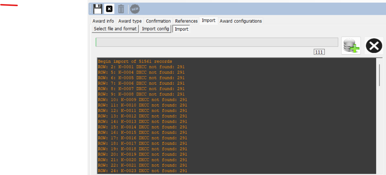

I'm trying to update the POTA reference list but the import gets stuck on the DXCC list.
In the .csv file the DXCC is a number (e.g. 291 for US mainland) in the "entityId" column.
If I try to import the file, I get a whole lot of errors in the black log screen. All stating "DXCC not found".
The most strange part is that some lines do not generate this error.
Any thoughts on this issue?

Posts: 11591
Re: New references e.g. POTA & WWFF
Does the file eventually end loading, bearing in mind that the file is huge so takes some time to load!
If it does eventually load do the references apear in the list and work correctly?

It does load eventually, but (by far most of) the references are not linked to a DXCC..... :?
Posts: 11591
It may be that after import log4om links to dxcc
Have you tried entering a call and checking if ONLY references for that country are available?
