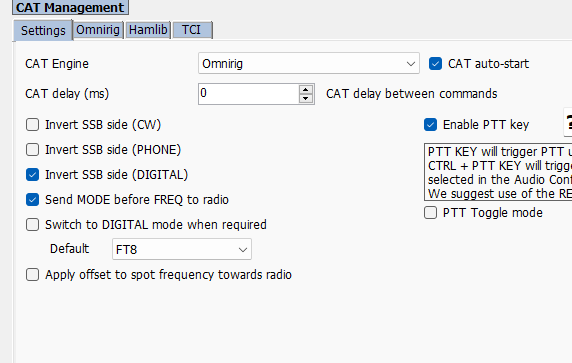

Normally I am operating in FT8 and when I change to SSB the mode also changes in Log4OM but when I
dial the VFO knob and change the frequency the mode got resetted to FT8.
How can I prevent this behaviour so that the mode stays in the selected mode until I switch back to FT8 ?

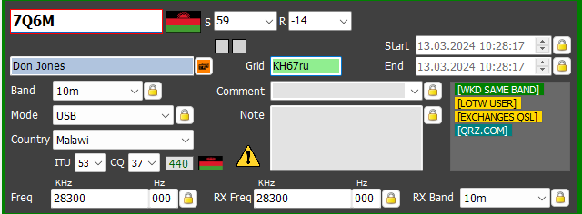

I also have the problem that sometimes I have to change the RX report from the FT8 dB value to S-Value
Attached you can find a screenshot of my settings and the raport "problem".
thanks and 73s
Stefan - DO9KW
Screenshot 2024-03-13 112856.png (20.41 KiB) Viewed 1430 times
Screenshot 2024-03-13 112823.png (23.01 KiB) Viewed 1430 times

Dont forger your FT software also controls the mode selected in Log4OM so if its still running when you decide to have a QSO on phone or indeed CW its still trying to control the radio and Log4OM

Sometimes the user has a wooden board before his head :D
Many thanks, that helped indeed ;)

I ran a test without WSJT-X running. I tested with the rig in USB and then CW. In both cases, when I got within about 500 Hz of the FT8 frequency, 24,915 in this case, Log4OM switched to FT8 mode. In Configuration/CAT Management, I do NOT have "Switch to DIGITAL mode when required" checked. In my case, I would never be operating SSB on that frequency, and it is very unlikely that i would be using CW there, Just thought I would let you know.
Win4Yaesu stays in the mode set by the rig, so that shouldn't be the problem.
