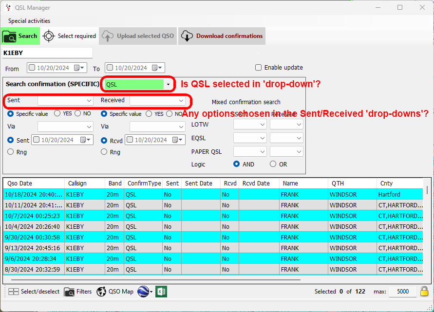

I recently received a batch of QSL cards from the Bureau as well as several via direct and I am in the process of responding to those QSLs. After viewing several YouTube videos as well as the written manuals I sucessfully printed my first QSL label without too much difficulty. My problem is that the QSL Manager seems to have now stopped working. When I enter a QSO call sign in the searchbox nothing happens and no QSOs are listed. I have confirmed that the QSO does indeed appear in the Main Log window. I have tried several QSL card callsigns without sucess. I have searched the forum for similar problems and found none.
QSL Manager fails to respond to Callsign Entry

Charles,
What search confirmation have you selected for your 'paper QSL search'?
Have you chosen any options for the Sent/Received values?
Those choices are 'sticky' for each of the 'Search Confirmation' choices which makes it easier and saves a couple key clicks when you use QSL Manager.

- QSL-Manager-QSL.png (58.17 KiB) Viewed 731 times
Re: QSL Manager fails to respond to Callsign Entry (RESOLVED)
Thanks so much, Nolan. In the "via" box in the received column I had previously entered "bureau". (From my first lookup which was a bureau card). When I removed it the information for the call sign look up appeared instantly. You are right, the options are sticky. I really appreciate your taking the time to attach a screen shot so I could see the problem.
