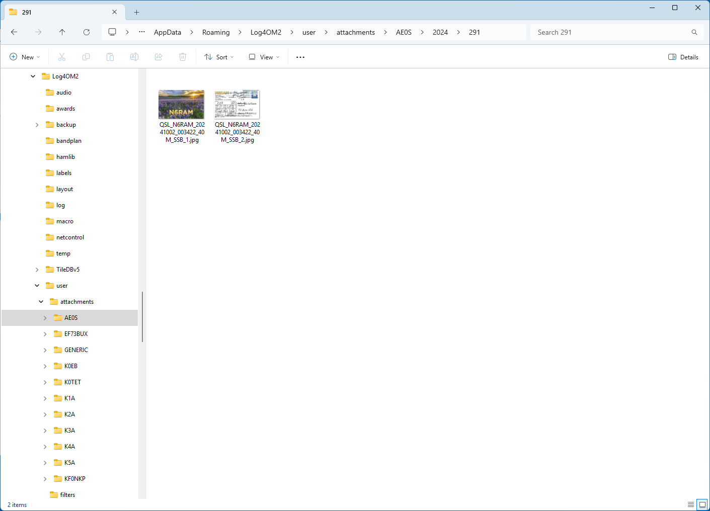

I'm running version 2.34.0.0 and tried out the new QSL image attachments. I'm running multiple Log4OM profiles each using a different database file. In my K5A profile the attachment is placed under my call sign AE0S instead of K5A. Definitely not good since that QSO was done with K5A.
In the profile the
- Station Callsign: K5A
- Operator Callsign: AE0S
- Owner Callsign: AE0S
Please let me know if I'm trying to use the attachment feature incorrect and this isn't a bug. Thanks.

BTW, a delete button is missing on the attachment page. What works is to track down the image in the file system and delete it once Log4OM is closed (not running). A delete button with confirmation dialog would really be nice. Thanks.
