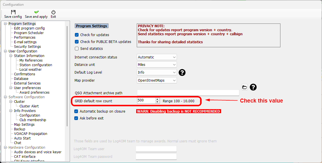

I don't happen to store my log(s) in the cloud, but one simple thing you can look at is the setting for your Grid Default Row Count.
They would be set by each Log4OM installation you have.
You can check that at: Settings / Configuration / Program Settings ... what value do you have entered in the Range Box??
If those settings the quick view of the QSOs on the panels with GRID Row Counts will vary.
See image ...
See image ...
