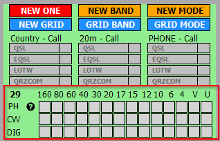

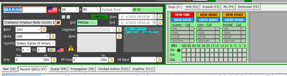

Is not this window supposted to work in contest mode? It works after you work a station, but is complelety blank when clicking on a station in the cluster (in contest mode). Would be nice if it worked in contest mode as well, since a lot of us ar not really contesting, but rather picking off stations we havent worked before (mode and/or band)
Stat window in contest mode

Re: Stat window in contest mode
Hello and Welcome. When in the Contest Mode (Green Borders Everywhere!) all QSO are subjected to the date range of the contest in the contest setup.
If you have never made a contact during the contest, it shows up as New One and the band indicators are clear as shown in your picture (not worked DURING the contest)
Likewise if you have made the same contact during the contest date range, it shows up as DUP or DUPE Group (different band)
If you turnoff the contest mode it will show normal
It's designed to help you see what you have not worked DURING the contest dates.
If you want to hunt stations that you need, turn off Contest Mode and watch the indicators.
Hope that helps.
