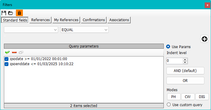

YES but that doesn't works with "use custom query"
this Pb is only with "Custom Query"
if I use "Params" that works fine
2025-03-01 11_22_40.jpg (34.53 KiB) Viewed 4044 times
Dan - F6FLU
https://F6FLU.org
Posts: 11571
Re: Custom query problem
well it works for me I just filtered 277 QSO's by date range using same parameters as your image from the 67,050 QSO's in my log
Are you sure that you had QSO's for those specific 2 days?
BTW you dont need the EXTRA 'and' because it defaults to 'And' without that
And you dont need to have the first line either it will sort all unless you add a filter for mode or band etc

G4POP wrote: 01 Mar 2025, 12:19 well it works for me I just filtered 277 QSO's by date range using same parameters as your image from the 67,050 QSO's in my log

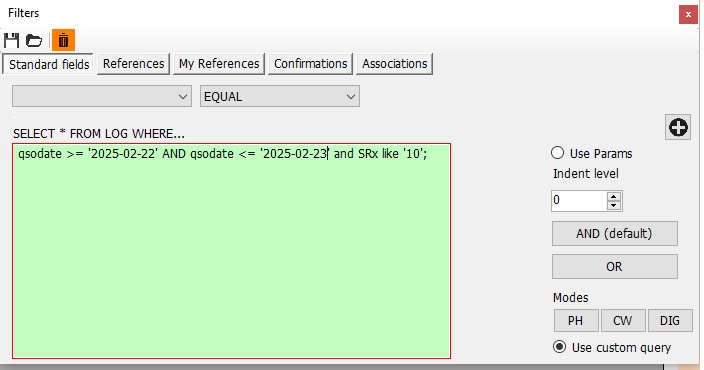

Hi Dan,
Please try this query
73 Manuel Fernando CT1BXX

CT1BXX
Posts: 483
Joined: 21 Jan 2013, 15:27
Post by CT1BXX »
F6FLU wrote: 01 Mar 2025, 22:45 Hello Manuel
NO that doesn't works ...
Hello Dan.
I am sorry that do not work. :oops:
Here I have tested and worked for me, however I want to tell you I'm not an exepert I'm just a curious person who likes to test, and in this process I've created the queries that I personally use.
Today I have family at home for lunch, but when I finish I will return to the subject and try to analyze within my small experience, however I will leave here the line of the query and suggest that you do "Copy/Paste" and try one more time.
Here is the complete text I am using: do not forget ; at end
Have a nice sunday and again sorry I have tried my best. :(
qsodate >= '2025-02-22' AND qsodate <= '2025-02-23' and SRx like '10';
