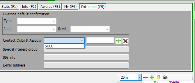

Re: Clubs support
Frank,
I've only selected the SKCC club in my configuration to follow. Thus that is the one that will be visible in the Main UI data window. Also that is the one that will appear in my Extended (F5) dropdown fillin.
Hope this might help your situation for a better understanding.
- club-skcc-selected.png (16.51 KiB) Viewed 4023 times
- club-drop-down.png (17.54 KiB) Viewed 4023 times

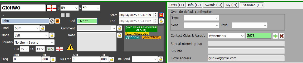

Re: Clubs support
Sorry for the delay, here are the screenshots of the settings and of the extended window, I hope I am doing it right
- ExtendedF5.png (45.31 KiB) Viewed 367 times
- clubs.png (86.69 KiB) Viewed 367 times
