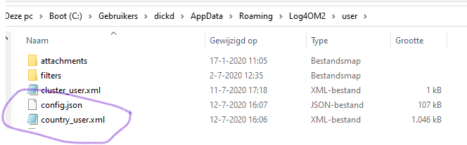

Thanks for your reply Terry,
As I wrote in my message I saved Country_user.xml in the 'user' folder.
However after a restart of Log4OM2 the wrong value from the original Country.xml is still displayed.
I checked the location of my Country_user.xml again, see below.

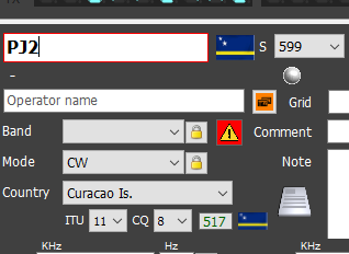

If I enter the call PJ2 in the main screen, the wrong CQ zone 8 is showing up in the field.

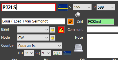

If I then complete the call to PJ2LS, the incorrect value 8 will be replaced to the correct value CQ Zone 9.
This correct CQ Zone comes from QRZ.COM because QRZ.COM is entered as the primary info provider.
the correct CQ Zone 9 is in the file Country_user.xml in the user folder as you specified.
