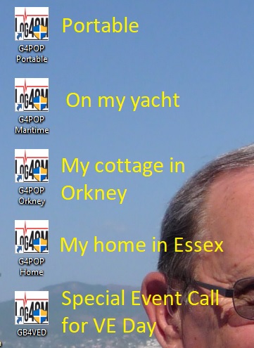

I suggest that you read this thread viewtopic.php?f=6&t=2641&p=15034&hilit=shortcut#p15034
My several different operations all using ONE COMMON DATABASE are accessed by the shortcuts shown below.
Each one with different station info and in some cases external logs uploads but all logging to the same SQLite database.

Thank you, that works exactly as explained.
