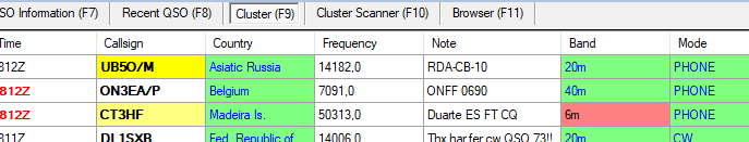

I notice that my explanation was incomplete and I will therefore give a more detailed explanation here. I also added some pictures for that.
Recently there have been a number of amateur radio activities where you could work stations several times per band, in a different mode (CW Phone org Digital). for example: Cervant's activity, Antartic Activity, Wild Atlantic Way Activity and recently Russia Football 2018.
When I look at the Cluster (F9) image,
Cluster (F9).PNG (13.62 KiB) Viewed 5725 times
I see that, based on the color, I worked CT3HF already but not on 6M. Also based on the color I see that I worked UB5O/M 20 meter, The same band as the cluster is showing.
When I single click UB5O/M and look at the Call entry field (see image Call entry field) I see the text
WRKD SAME BAND

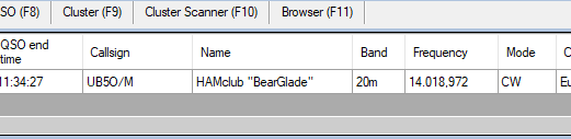

Now I have to Click on QSO Information (F7) to see the previous QSO to see the operating Mode
QSO Information (F7)2.PNG (6.01 KiB) Viewed 5725 times
I now see that I worked UB5O/M on 20 Meter with mode CW. The cluster entry is showing UB5O/M in mode PHONE. So I can work that station that will count for the Activity. It is not a DUPE because the operating mode is different.
If it is possible to add an extra Cluster color based on 'Station worked same band and same mode' it is very easy to see at the clustertab in my example That I worked UB5O/M already on 20 meter but not in the mode PHONE.
I hope this is a better explanation and will make sense to you now.
