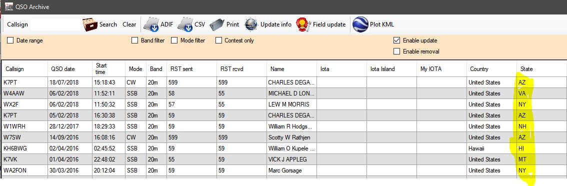

Have yo checked how the state was saved in the QSO's? like below
Re: FT8 QSOs not showing in Statistics and Awards
Terry....
Bingo, you have hit on the problem again, I hope an easy solution can be found.
