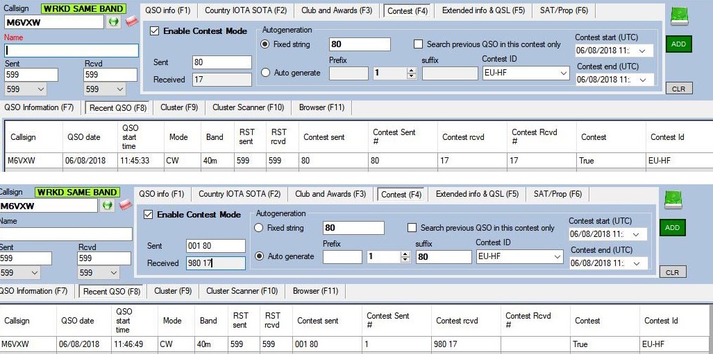

The images that you sent me indicate that you have used the 'Auto Generate' fields instead of the 'Fixed string' field and that you were entering the RST sent in the sent exchange together with 17 and the RST received exchange together with the other operators date first licenced in the contest received fields, that was your problem!
The RST sent and received are those in the sent/Rcvd fields directly below the other operators name on the extreme left of the window, you dont need to add them into the contest exchange fields.
All that goes in the CONTEST sent/received fields is the actual exchange like serial number and any other string like Age, date first licenced etc so in the case of the EU-HF contest you would use the 'Fixed String' field to add 17 to the sent field for every QSO and you woud have entered the information received from the other person just 81 or 49 whatever year he gave you.
Not as you entered 59 17 in the contest sent field and 59 64 in the contest received field - The RST is already recorded in the RST sent/Rcvd fields.
See the two different examples below, one with just the fixed string required for the EU-HF contest and the bottom one for an imaginary contest that required an incremented serial number plus a suffix - Note: one used 'Fixed string and the other an 'Auto generated' serial number plus a fixed suffix

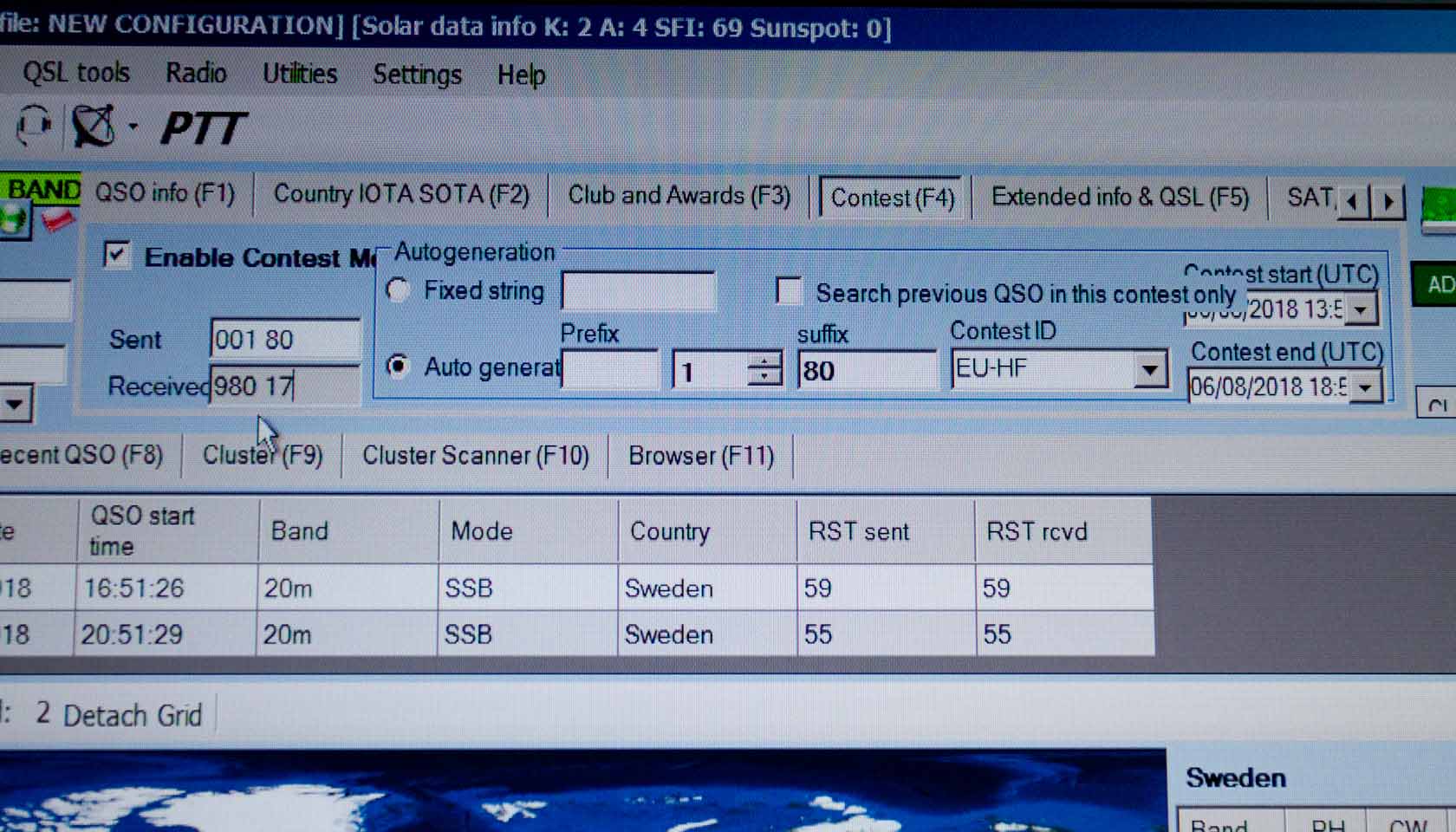

The fixed string is working perfectly but the auto generate still dose not work
Posts: 11602
Re: Contests
Exactly how do you think it's not working?

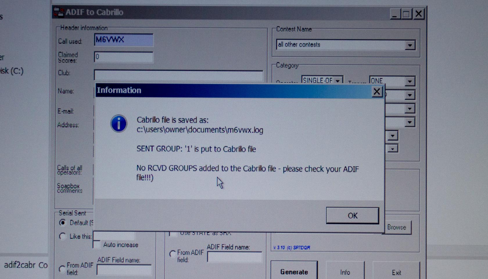

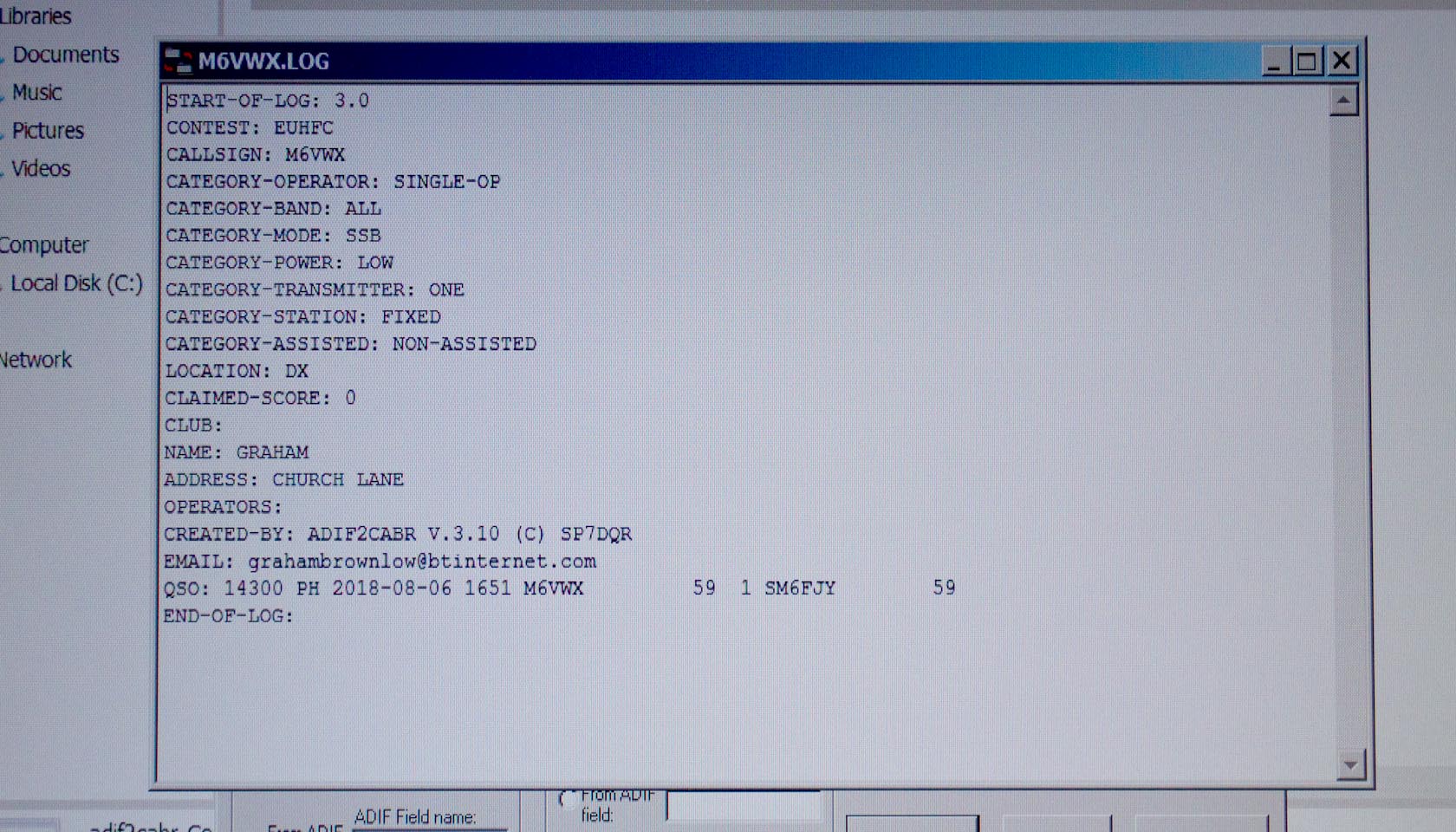

I filled it in just like you and when you get to cabrillo file some of the numbers are missing and it tells you there is a line missing
