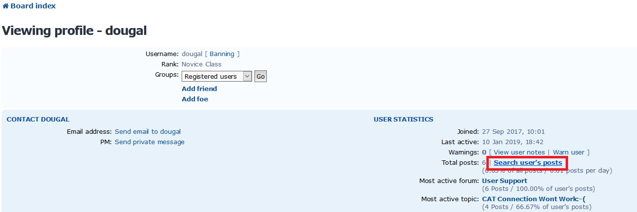

lol thanks Terry.
Can you please tell me how you searched for that?
Re: Another CAT Connection Issue
Humble apologies! Couldn't see for looking:-)
