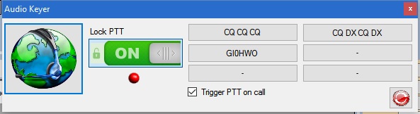

The 'PTT' button on the main window is just for activating the radios transmit function it is not for playing back audio messages from Log4OM - I have just tested this function and it is working fine with the PTT triggered via a com port.
I would not expect this button to trigger the TX on your radio when using a Signalink because the Signallink only triggers the PTT when it receives audio not a com port command.
The voice recorder is activated from the 'Radio' drop down menu by selecting 'PTT' (Must get this changed to Voice Keyer sometime) but remember that you must keep the message button depressed to send the message - Its click and hold not a toggle on and off
I have just tested that the voice keyer works and it functions 100% as designed
To delete a message either record over it or go to the Audio folder and delete the files (Help/Open configuration folder)
