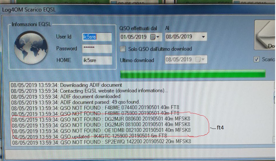

Hello i have this problem in download images by e-qsl. All FT4 qso are not found and the mode is MFSK8. Into my log4om qso are in FT4 mode.

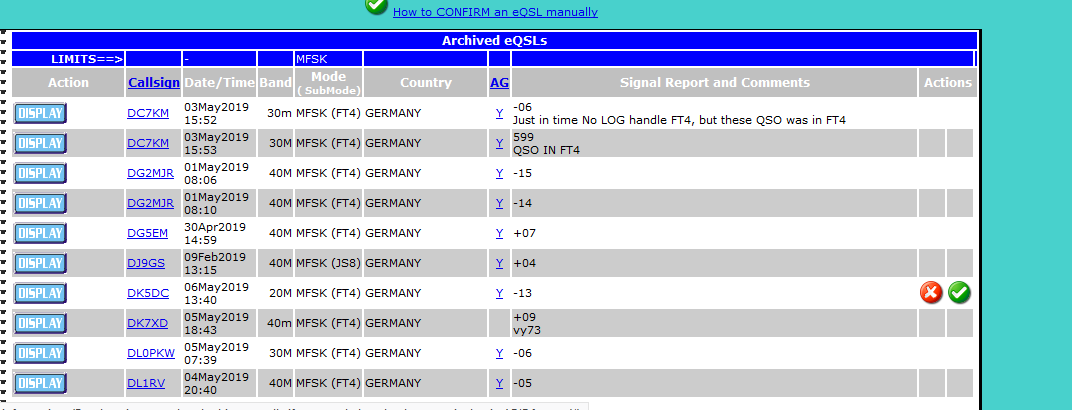

in eqsl ft4 mode is mfsk (ft4)

FT4 = MFSK8 ???

Same here, it's seems FT4 was accepted by Eqsl as mode : MFSK and Submode : FT4 ? 8-)

No solution? It's a e-qsl problem or Log4om? because i know that it's working regular with BBlogger and Swisslog.

I tried to edit the mode_list-user file with a new line:
MFSK;MSFK;MFSK:FT4
but is the same,no download images by e-qsl .

ik5sre wrote: 11 May 2019, 12:38 I tried to edit the mode_list-user file with a new line:
MFSK;MSFK;MFSK:FT4
Well, remove your line and try this instead > FT4;FT4;MFSK;FT4
