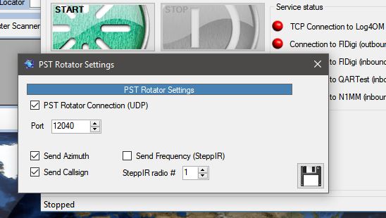

In PSTRotator Menue "Comm" - "UDP Control Setup"the only difference is that I cannot find where you entered the IP address you mentioned (other than Communication/TCP Client, whereas I use RS232/TCP server to communicate with the AlfaSpid controller). Also, where did you select ‘Automatic positions reporting’?

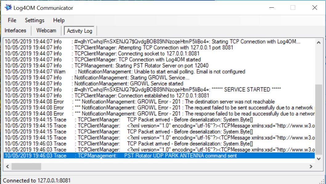

Switched off Kaspersky Antivirus software. Ditto Windows Defender.
I've attached the Communicator logfile, complete with error messages (which are all beyond me...).

Have you set up the Log4OM communicator for PSTRotator as below?
This is how it works....
1. Log4OM sends the message to set rotator to the Log4OM communicator
2. The Log4OM Communicator hen forwards that message to PSTRotator
3. PSTRotator activates your rotator
The message is clearly being sent to the communicator and onward to PSTRotator, we can see those actions inn the log files that you posted
So either you have not set up the communicator as above, or there is something perhaps blocking the message between the communicator and PSTRotator.
BTW the error messages re Growl, which is used for sending DX Spot alerts, is because the Growl server no longer functions so just disregard them they are not associated with the rotator control.
If you cant resolve this by setting up the communicator correctly please generate a support request and email it to me. The instructions about sending a support request are here http://www.log4om.com/log4om-support/
