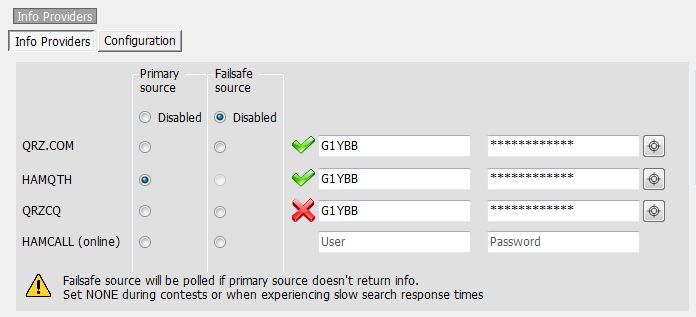

I'm not getting QRZCQ too pass on the page below. When I got the X I thought ah wrong password, so headed to the actual website and logged straight in. So user and password are correct.

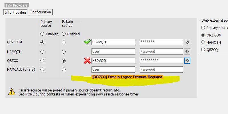

Steve, it seems you are a "Standard" QRZCQ user. Premium membership is a requirement in order to use XML API service.

Steve, for qrz.com you have to subscribe to https://shop.qrz.com/collections/home-p ... ion-1-year to use their XML API.

I do understand that (you can see I have HamQTH set as my primary in my image).
But I do not understand why I can use the check button and it is OK on qrz.com but not on QRZCQ ?

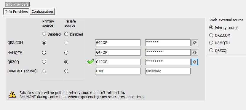

I just checked QRZCQ and its working fine when using the normal user name and password that I would use to log into their web site
From this I have to suspect that you have a local issue, please email me so that I can help at g4pop (AT) ARRL.net
