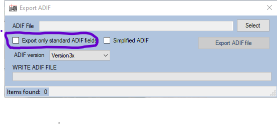

When exporting an ADIF file from V1, there are a couple options that can be set but I cannot find what is recommended. Here's the export window.
ADIF Export.png (12.88 KiB) Viewed 3342 times
I have found where ADIF Ver 3x is recommended but what do I do with the Export only standard ADIF fields? Selecting and not selecting this checkbox results in the export file being a different size so it does something. What is recommended here?

Thanks for the reply. I am aware of Version 3x being preferred, Terry has that is documented in the user manual. My question was about the checkbox "Export only standard ADIF fields". I have run the export with and without this box checked and the resulting files are different. I've looked at those rather quickly and this is added to the end of each record when the box is not checked.
<CLUBLOG_QSO_UPLOAD_STATUS:1>N <HRDLOG_QSO_UPLOAD_STATUS:1>N <QRZCOM_QSO_UPLOAD_STATUS:1>N <APP_LOG4OM_VALIDATED_CALLSIGN:1>Y
<APP_LOG4OM_MANUAL_DATETIME:1>N <APP_LOG4OM_MOBILE:1>N <APP_LOG4OM_QRP:1>N <APP_LOG4OM_PORTABLE:1>N <APP_LOG4OM_MY_ANTENNA:21>TA-33 & 80 Meter Loop <APP_LOG4OM_CONTEST:1>N <EOR>
It seems to me this data should be included in the export to make the imported V1 QSOs complete.
Perhaps it should be recommended that this box NOT be checked when exporting from V1.
73 - Tom NS8K
Posts: 11612
Re: V1 ADIF Export Settings
Export standard ADIF fields - Exports the basic set of ADIF fields does not include program specific fields which are not included in the ADIF standard.
Simplified ADIF - A very basic subset of the standard ADIF fields intended for some external programs that cant handle the latest ADIF specifications
If you are exporting with the intension of importing the file to Log4OM version 2 please follow the instructions we provide and export an ADIF 3 file and ignore the two selections above.
