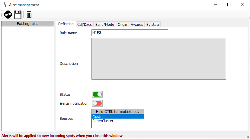

Sure Rien, here is the basic workflow to setup an Alert based on a Callsign - I am going to setup a rule to alert me when *my* callsign is spotted.

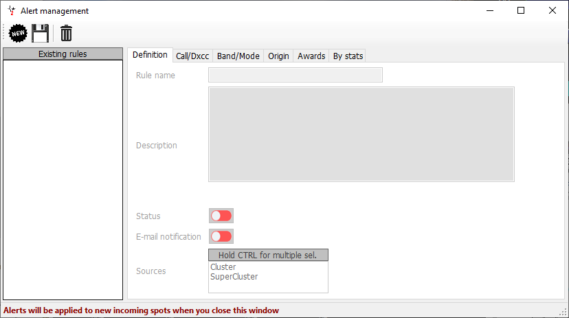

1) Open the "Alert configuration" window from the main "Settings" menu option.
2) Give this new Alert rule a name (in this case I'll use the callsign I'm looking for - Me! hihi) Here you can also select whether you just want the pop-up alert ("Status") or whether you want an E-mail notification. Also here you select whether the source for this alert should be a Cluster or the "SuperCluster" (I use CCUser so I don't have knowledge of the SuperCluster.)

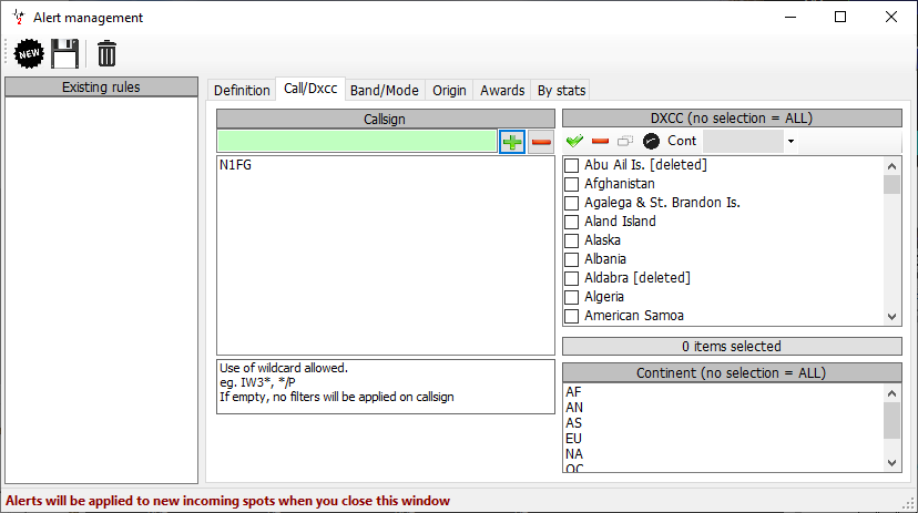

3. Now the important part - select the "Call/Dxcc" tab and enter the callsign you are looking for. Note that you can use wildcard (VK* for example) and additionally select the DXCC entity (or not) and the continent (or not). But the thing to remember is that you MUST put something in the Callsign box that will be matched against what the cluster(s) are reporting.
4. You can go to the "Band/Mode" tab and (if you want) select which bands/modes you want to match.
5. You can use the "Origin" tab to enter information about where the spot originates from (where the call was heard). Note that as in many of the options - you don't HAVE to enter anything, as it defaults in this case to anywhere!
6. Once you are finished fine-tuning the rule to your preference, make sure you go back to the "Definition" tab and SAVE the alert! (Use the floppy disk icon.) Once a rule is defined you can enable or disable it which allows a lot of flexibility.
(Sorry, the forum only allows 3 attachments so I hope you got the main idea and were able to setup a rule to play with.)
