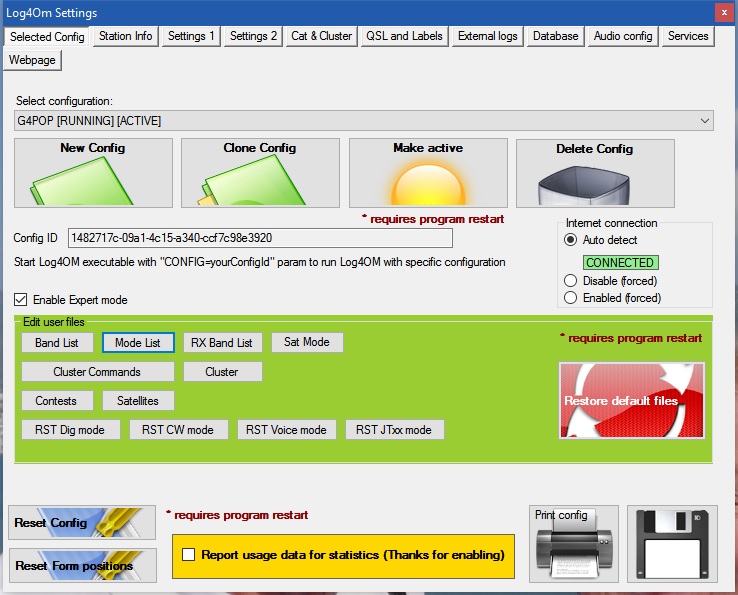

Re: New mode integration
Options/Select config tab
Check the 'Enable expert mode' box
Click 'Mode list' button
Add the mode(s) that you require
File/Save
Restart Log4om

As a user it is your choice if you want to add SIM31, or any other mode to the list, just use expert mode in the Options and edit the modes
If you also want to provide a 599 report for SIM31 edit the modelist.csv file by adding SIM31 to the list of Data modes, this file is in your Log4OM configuration folder - Help/ view configuration folder
Log4Om is as user configurable as you wish to make it but please be aware that SIM31 is not a supported mode in the latest ADIF specification and it is not so far proposed for the next ADIF release!
