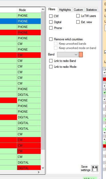

Either use the built in filters in the cluster side window as below
Or if you require more in depth filtering send the relevant filter commands from the Log4OM utilities/cluster window using the filters that are explained here:
http://wiki.dxcluster.org/index.php/DXS ... ing_Manual
