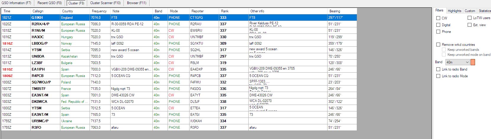

would be fine for version 2.0 if FT8 & JT65 Spots (..74 & ..76) would be excluded on cluster filter "Phone" :-)

Edit your bandplan to list the agreed FT8 and JT65 frequencies as DATA then activating the Phone filter will exclude them
You will of course then miss any phone operator that is transmitting on the agreed data frequencies

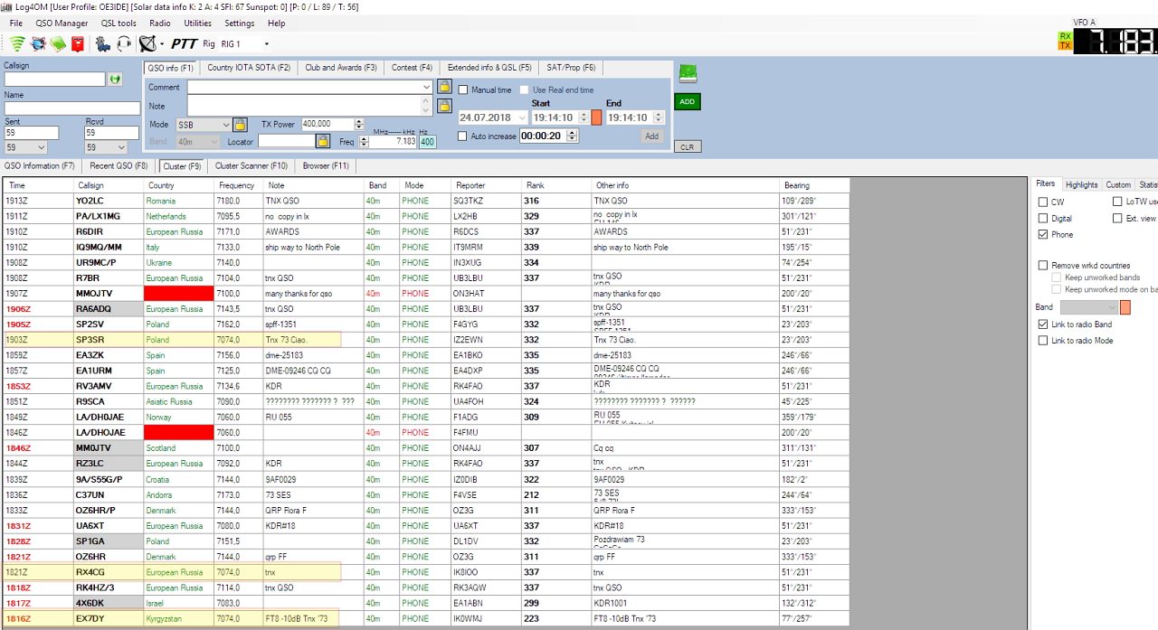

it doesn't work for me.. maybe I missed something:
7074 should be recognized as "DIGITAL". See my bandplan.xml:

i tried it with your cleaned 40m bandplan (bandplan_r3.xml)

But obviously it does'nt work for me as expected ...
