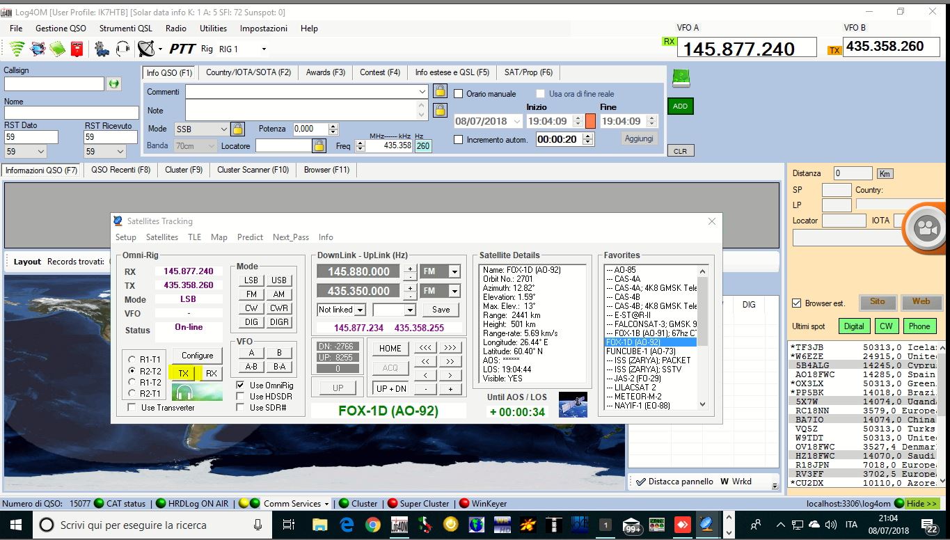

Hi everybody,
i have an issue using my ft847 and LOG4OM. I use this RTX for sat QSO's so i open PSTROTATOR with Omnirig and everythings works fine. If i open LOG4OM i see on the top, in the right corner, the two VFO frequencies but TX and RX are inverted!
Any help will be appreciated ;)

I' using the .ini for the FT847 included by Codrut in PSTROTATOR installation directory. In PSTRotator the RX & TX frequencies are showed right (as you can see in the picture above). I have an inversion in LOG4OM.

i think i found the solution! :)
I have trying to modify the ini file with no success. Than using the ini file of PSTRotator i found out the two button in PSTRotator, not well explained into the manual, labeled TX and RX. When i click on TX button nothing happens in PSTROTATOR but the situation TX & RX in LOG4OM is reversed! Just what i needed ;)
Thank's a lot for your support!
Dave IK7HTB

Actually this doesn't solve the main problem.
Indeed it is not a correct solution at all.
Clicking TX puts the radio on TX mode...(same as you press PTT) and meanwhile Log4OM shows the correct order of RX and TX frequencies.
So, with this solution you "have to" add the qso while pressing the PTT (or TX button) to record correct TX frequency of the radio.
Otherwise you add the qso with RX frequency.
And the problem i mentioned on another post still continues..
If you put radio on Sat mode, Log4OM starts to read split mode frequencies as shown in this viewtopic.php?f=6&t=3580&p=20076#p20076 topic..
And if you turn off sat mode, display never returns back to single VFO mode..
Adding omnirig log also..
WHich simulates. opening log4om on vfo mode..
switching to sat mode..
pressing ptt for a few times..
then switching back to vfo mode.
