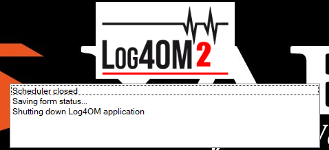

Good Morning,
I have been running V2 for a few weeks now and have been having the attached error when closing the program. It just sits at this screen and will not progress.
I am using the program with a Yaesu FT-991-A and using Omni-rig, using version 2.6.1.0
Any assistance or ideas would be great,
thanks
de
Steve - VK4FI
Close error.png (21.33 KiB) Viewed 4702 times

Have you got LOTW auto upload on closing selected or any other auto upload?

yes I have, is that the problem?

VK4FI wrote: 06 Jun 2020, 04:56 yes I have, is that the problem?
Its not really a problem as such Steven but, it can take a minute or three to complete the process before that close down window go's away.
John
Posts: 11612
Re: Shutdown error
Sometimes the upload to LOTW can take some time because LOTW gets busy, so it depends how long the message remains on screen
If the message never disappears then disable the auto LOTW upload and see if that resolves it and let me know the outcome

I have tried it with LOTW upload on close selected and it never disappeared. I even left it for several hours.
If I turn that option off it closes correctly.

Set the log mode to Trace in the help menu
Set upload on close down for LOTW
Close the program
Reopen log4om and EMAIL ME THE LOG FILE DO NOT POST IT HERE
