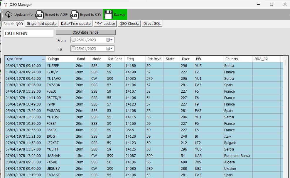

I want to export my QSOs in an ADIF file,
1) I use the "utilities / QSO Manager" menu
2) I display the QSOs I want to export
3) I sort these QSOs by ascending date
4) I export

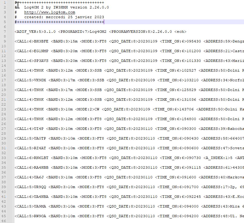

In the generated ADIF file my request is not respected, the QSOs are not exported in the order I chose (increasing date)
Would it be possible to consider modifying this export in order to respect the display that we have chosen

Dan,
I've updated a pending Mantis ticket to correct this and/or make it an option for the OM to choose and retain sort order of exported columns.
Fingers crossed!!
