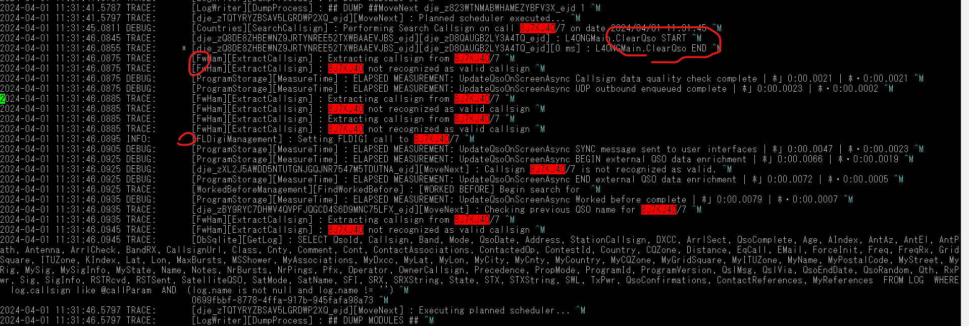

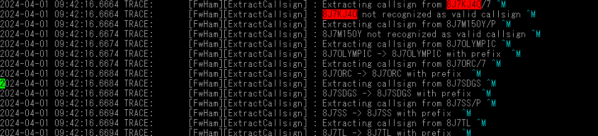

I tried collecting Log4OM2 logs. Looking at this, it looks like you haven't even accessed QRZ.com.
When I enter 8J7KJ4O/7 and delete each character with Back Space, many WORKED BEFOREs are displayed, but 8J7KJ4O/7, which has already been QSOed, is not displayed in WORKED BEFORE.
So, it is probably not a problem with QRZ.com, but that it is not recognized as a call sign.
Kiyo

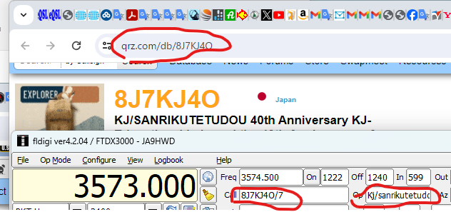

I'm curious why it sends 8J7KJ4O to fldigi when Log4OM2 says it doesn't recognize it as a valid callsign.
Kiyo

When I tried setting the same user and password for fldigi as I had set for Log4OM2 and put 8J7KJ4O/7 in the call sign, the page was displayed in the browser and the name was displayed in the Op field of fldigi. I'm not convinced by the difference between this and Log4OM2's behavior.G4POP wrote: 01 Apr 2024, 08:23JA9HWD wrote: 01 Apr 2024, 00:18
I think it's strange that when I search manually on the web, everything is fine, but Log4OM2 returns an error.
On the Log4OM2 screen, in the case of 8J7KJ4O/7, "[SEARCHING...]" is displayed momentarily and then disappears.
I don't think it matters whether I am a paid subscriber or not for the processing up to this point in Log4OM2.
Even if the search fails, the log itself will be entered, so it is not a big problem.
I did try to explain why in this statement in my last post
"Please be aware that when software interogates QRZ for a lookup it is via a QRZ API which does not always contain the same information found during a web site lookup, we do not scrape the web page as some apps do."
In other words sometimes the data supplied by QRZ to Log4OM via the API lookup is not always the same as you will see on the QRZ website
Set Log4OM to Trace or debug mode and watch the realtime log and you will see what happens when Log4OM is doing a lookup
Adding just the prefix to the non standard call sign list (NSCL) will exclude all calls with that suffix instead of just the one call.
When a call is in the NSCL the lookup is not carried out at all so nothing will be seen in the input GUI
Incoming data via UDP goes through the same lookup routine if you have instructed the UDP connection to use lookup
So at least I don't think it's a problem with QRZ.com.
73, Kiyo JA9HWD
