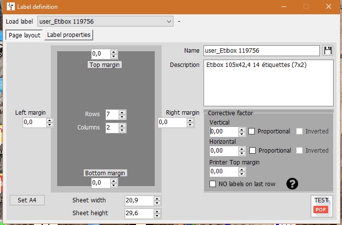

This is my template :
My Page layout :

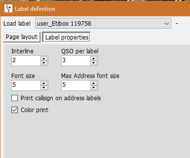

My label properties :
Log4OM Label properties 2020-12-25 093747.jpg (23.47 KiB) Viewed 3754 times

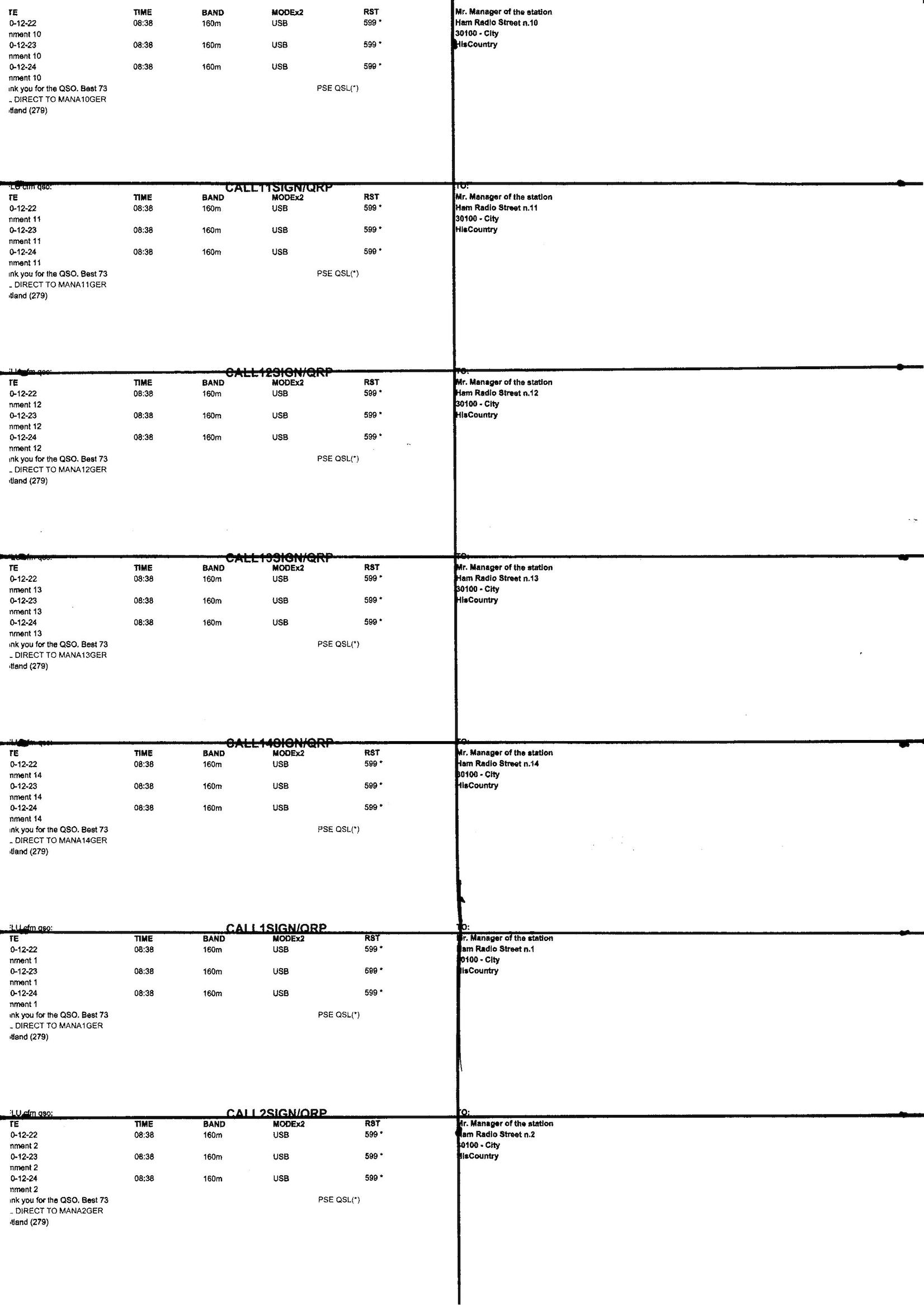

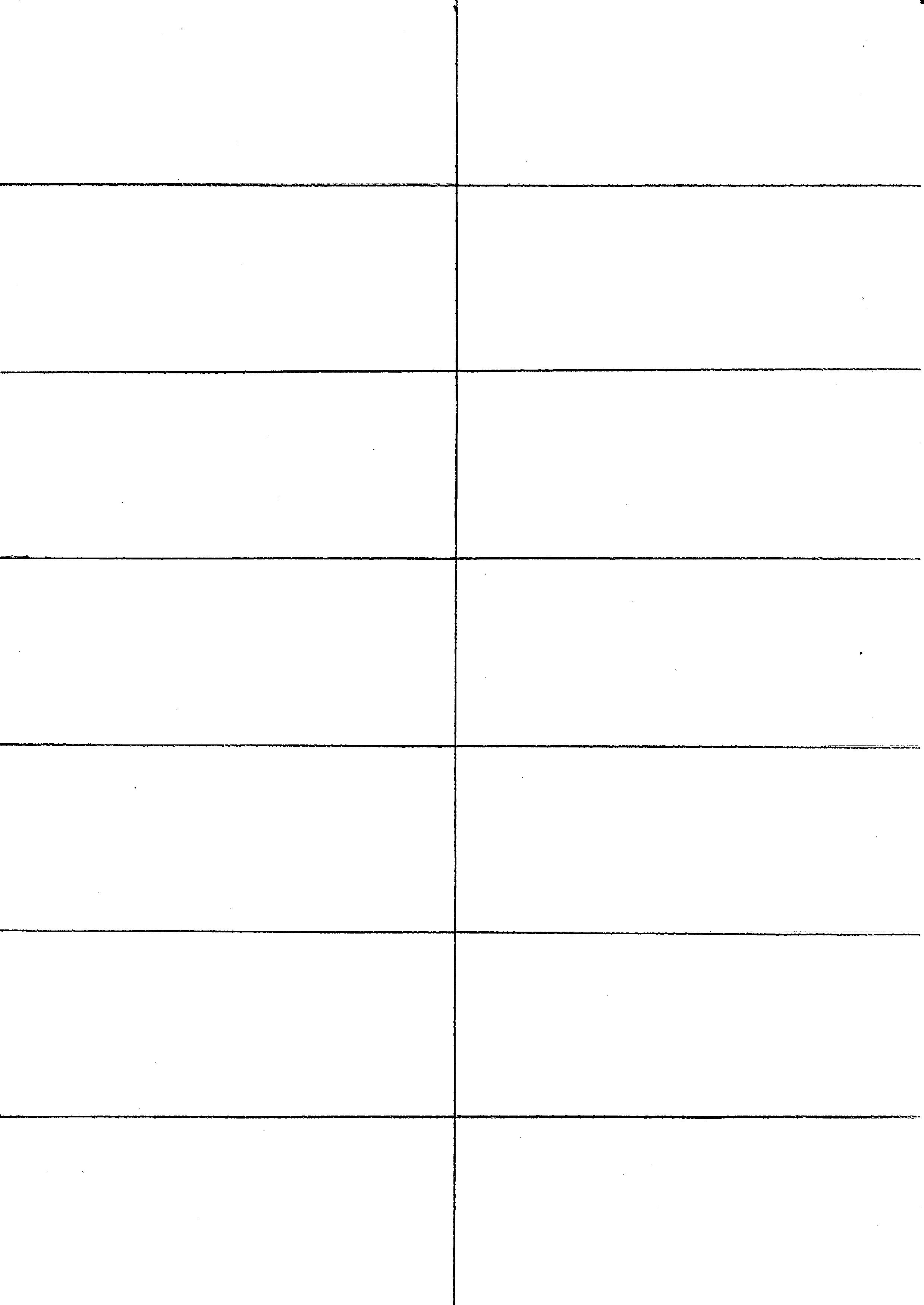

I print the Test File PDF from the page layout
20201225083851.pdf
(4.07 KiB) Downloaded 196 times
The same with the drawing of the labels (not precise drawn by hand) just to see that there is indeed a vertical offset of the labels
that the printing on the left begins "in the void" and that the right column begins just on the line. It is therefore necessary to give margins so that all this is coherent. so i will then show my margins settings

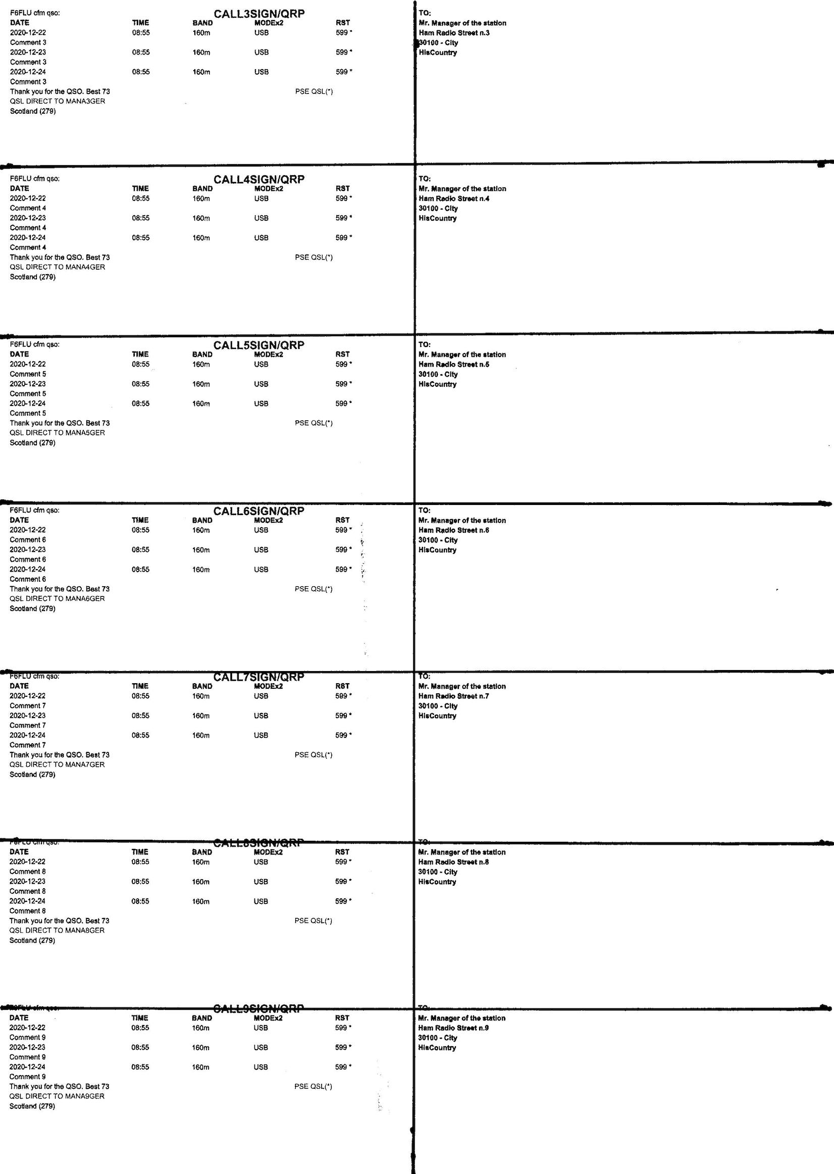

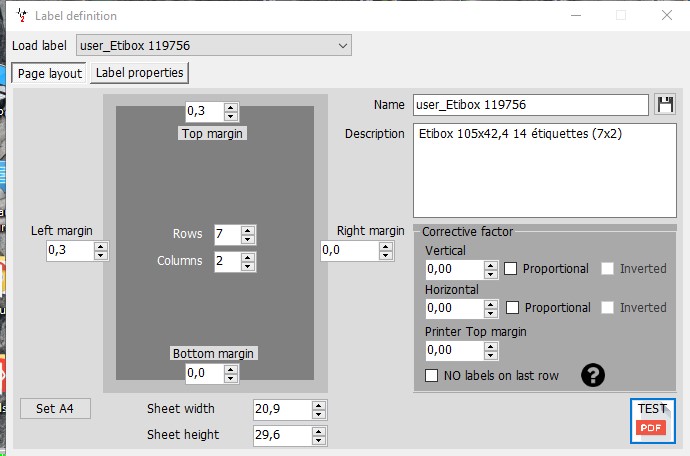

Now I set margin and save my template :
Page Layout margin 03 2020-12-25 095904.jpg (57.94 KiB) Viewed 3752 times
we see that now on the left part everything is well written, we also see that there is always a vertical shift and that on the right column we print well on the right label
