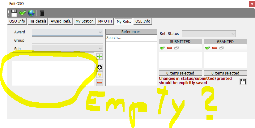

Maybe I am using the station configuration not correct but:
I would expect that the selected references (check box selelected) i.e. a SOTA reference should for all the newly logged QSO be set as my reference? That's how it worked before.
No references are listed for the QSO:
I did not find any information in the user manual how to do that.
73 de Joe

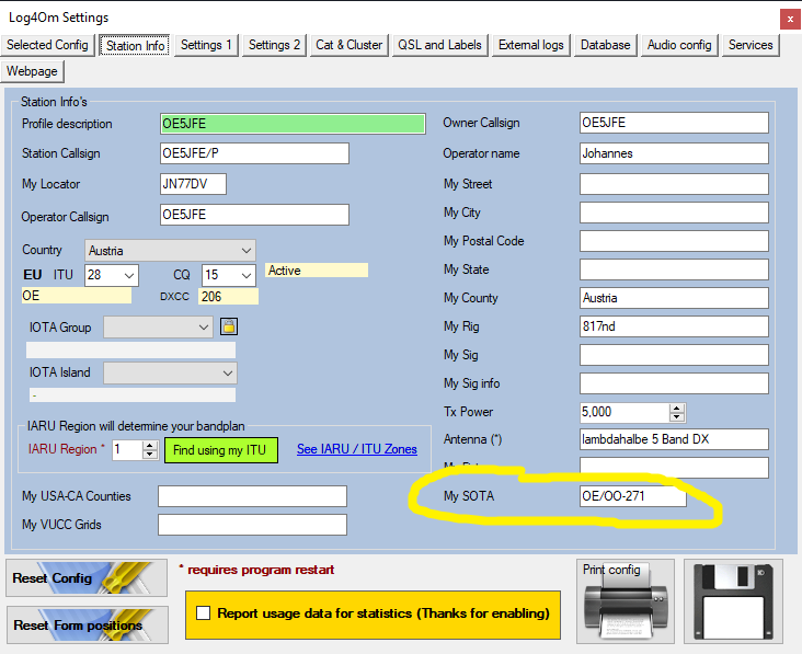

To make it clear how my workflow used to be in version 1.4:
1.) Update Station configuration:
- change locator
- change my sota reference
2.) Change to manual QSO time and spacing
3.) enter/transfer from paper all QSO from the activation one after the other (of cource with RST, mode and so on for each QSO) to log4om
With that way all entered QSO had the correct "MY_SOTA_REF"
for the next activation I changed the My SOTA and everything was fine.

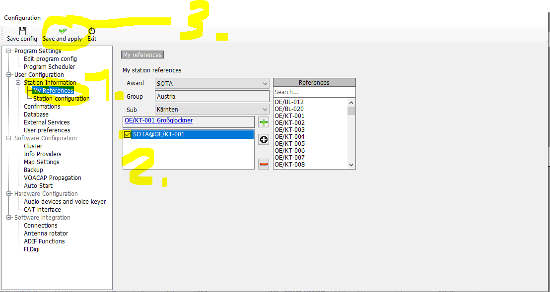

I just tried this for you and this is the correct procedure
1. I changed the station call sign in Settings/Program Configuration/station information to OE/G4POP/P
2. In Settings/Program Configuration/station information/My References selected SOTA award.
NOTE
A point to watch! because my call is an English call the list of SOTA references are all G/ so what you do is click the Black + (Plus or Add) sign - Enter the Reference, I entered OE/OO-271, and click enter on the PC keyboard. Now that ref is in the references box bottom left.
3. Click save and apply
I then entered a trial QSO with Lele and as you will see from the screen shot all is recorded correctly.
Entering historic QSO's is just the same by going to manual date and time except you dont have an automatic time advance at this time.
After entering the activation results just edit your station call sign and uncheck the OE/OO-271 box and save and apply
Hope this clears this one up, I will add it to the user guide to save future confusion.

The QSO list table shows the correct information for "My references". See screenshot. But I still think if you double click the QSO to edit it the tab "My Refs." should show the same information? Otherwise how could one correct/modify it later?
The tab "Award Refs." in the Edit QSO windows does as expected show all the details.
My feeling is that the data (My Refs.) in the edit QSO dialog is not read correctly (or at all) from the dB.
Thanks for having a look at the issue.
73 Joe

You need to understand that where you THINK you should see your reference is not what that window is for!
It is so that if you suddenly decide to add another reference to the qso you can, not for the display of any default references that you set in the config

But you can see in the video that the correctly added "my references" that are a value of the QSO (taken from the from the default settings) get completely removed (dropped, forgotten) when editing a past QSO. The populated field is then empty.
This also happens i.e. if I only change the RST or add a comment.
Is that intended?
73 Joe

The edit and emptying of the information is an issue that is known was reported by Greg last week, if we didn't include that fix in today's release of 2.1.0.0 it will be in the next one.
