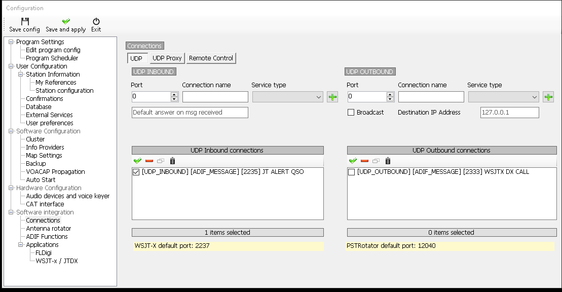

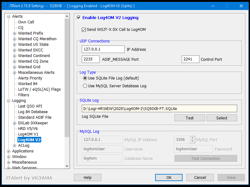

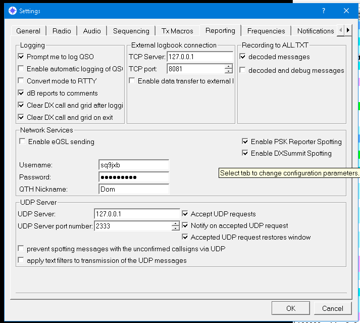

Hello, W7DRM
I attach screenshots of the Lof4OM2, JTDX and JT-Alert settings
With these settings in Log4OM 2.2 everything works as it should.
EDIT: Remote Control : Port 2241
