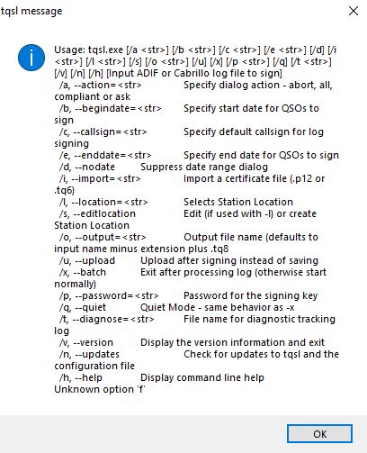

Trying to do a TQSL upload to LOTW, either manually or as part of a shutdown routine, no longer works. I get a popup box like this:
Any ideas what to do about it?

What's your TQSL version?
It seems your TQSL is not supporting the new "-f UPDATE" command provided by the last generation TQSL software.

Ciao Daniele,
The upload window says TQSL version 2.4.7. Final status is "Command Syntax Error(10). It has been working OK under Log2OM version 2.14 (and previous) until I did the upgrade to 2.15.

Re: v2.15.0.0 Upload to LOTW no longer works
It's OK now thanks. I see from the LOTW web site the current version is 2.5.7. I updated and it seems to be OK now. Could I please suggest that the release notes for 2.15.0.0 should mention that TQSL should also be updated.
