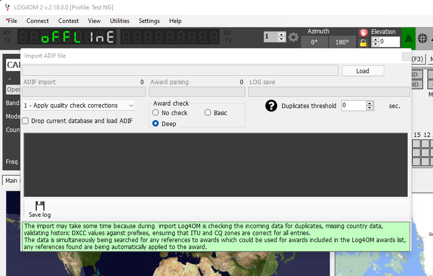

Hello all, on the last update I have to import some ADIF data but Import button does not made nothing.
This has been tested on two differents computers with the same result.
Thank you so much!!

Log4OM 2.18.0.0 don't import ADIF files

Well I don't know but what does not work is the function of the import button... This don't do nothing after press "Import" and consequently the data on file has not been readed. I don't know if I not described correctly.

Same problem for me. A simple adif file with 1 entry, clicking on Import does nothing. It used to work fine until this update.

I did some testing for someone with the same problem and it seems that this problem only occurs with an ADIF that only contains one record (QSO). In that case version 2.17 works as expected, but in v 2.18 nothing happens.
I tried the same with an ADIF with 2 records and then the import works in both v2.17 and v2.18 without any problems
