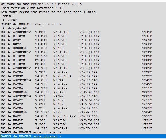

Are you sure it wasn't a temporary failure of the cluster? because it all seems to be working fine for me this evening

The screen you're showing (f3) is loading just fine. This data is not being transferred to the (f9) screen. That's the
screen I work from where you can click to the spotted frequency and the ref info is loaded onto the log automatically.
gene.

I believe SOTA have changed the data format and have asked Lele to check this out

Danielle,
The cluster is loading correctly into SotaWatch2 and N1MM.
BTW I just noticed that the MM0FMF cluster is showing a revision
dated Nov. 27th 2016. That is about the time it stopped loading
onto f9.
