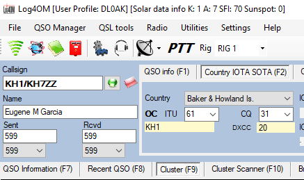

Hi Glen,
don´t know what´s wrong at your side but here is working fine (see screenshot).
B.t.w. which version of Log4OM are you using and all the data files up2date ?

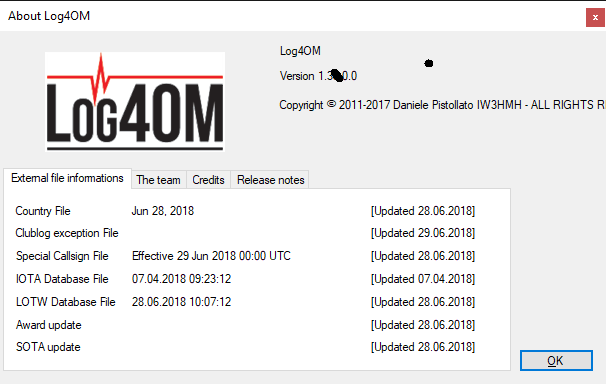

Re: Callsign Lookup not working right
have tried this but always Hawaii ....
Version is the latest for the test team ... ;)
