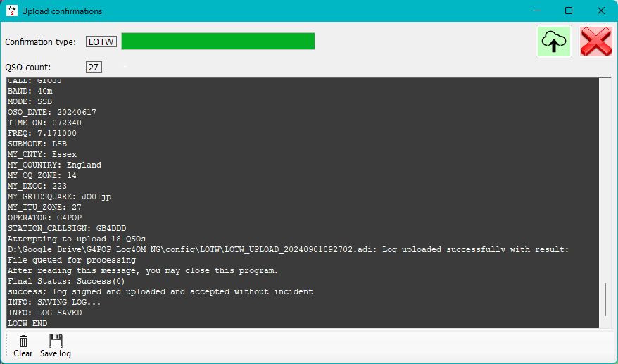

I just tested upload and download and bot worked fine version 2.33, see image below
