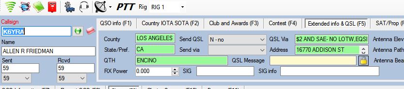

I just did a check on your call and see that in HamQTH you have not completed the QSL Via field and there is no mention of a QSL manager in your QRZ biography either, this is why the QSL via field is empty in Log4om
You need to add your QSL managers details for your manager to be displayed in our QSL via field
This has nothing to do with the fact that you have noted on the on line look up web sites that you QSL by Mail, EQSL or LOTW it is purely for supplying your QSL managers details or you might add to the on line QSL Via field a text message like 'Only QSL upon receipt of US$2 plus SAE'
example
example
