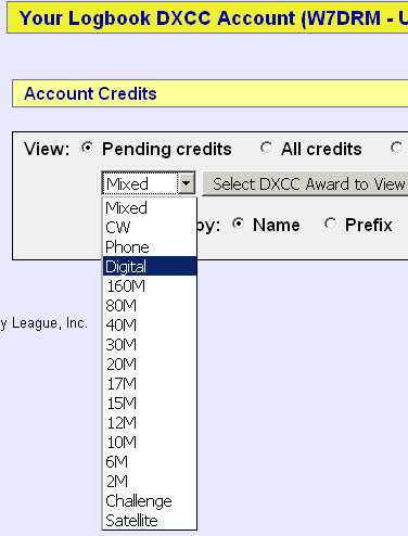

w9tvx wrote: Better award tracking/management. Currently built-in awards such as WAS and DXCC seem limited. For example ARRL allows for rewards by different digital modes (JT65, etc) while Log4OM only seems to support a single Digital mode. Along this line, it would be great if the user could create custom awards that take different digital modes into account - currently it seems as if only Phone/CW/Digital are supported. This is probably my biggest issue and currently I am running Log4OM and HRD in parallel for this reason
As far as I know, (I could be wrong) but DXCC is limited to "Digital" for all digital modes. WAS is another matter and does break them down by digital mode. So Log4OM WAS categories probably do need to be expanded.

Thank you for taking the time to write such a complete response. You are of course right about DXCC supporting only digital. It still would be really nice to have support for different digital modes for WAS and for custom awards. Thank you again
