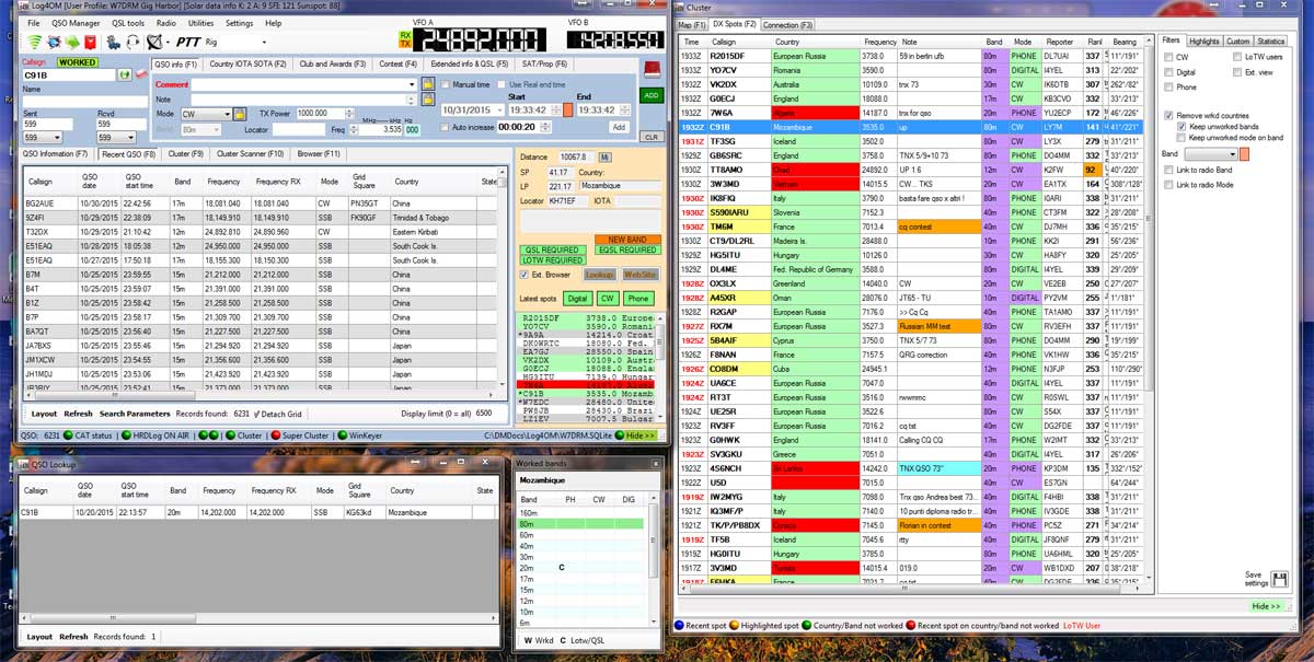

Hi Brian,
Have you tried "detached" windows? Many of the things which you want to see simulaneously can be seen if you detach windows and place them as desired. Of course, this depends on your monitor size, monitor resolution and number of monitors.
Here is a screen shot of my typical layout with the separate Cluster window launched from the Cluster tool bar, QSO Info (F7) detached and the worked/confirmed band grid (also on F7) detached. Then I have all information available including my log. Or I can switch to Cluster Scanner (F10) on the main window.
I also use Band Master from Afreet software, which runs with OmniRig, which gives you a vertical cluster scanner. Hopefully some day Log4OM will have its own version of that scanner, or integrate with Band Master.
All this fits on one 24" monitor at 1920 x 1080 resolution. I normally use 2 of these 24" monitors, and can go to 3 monitors for contesting.

Doug - thanks for that info. Yet another feature that I somehow overlooked. I had to look in the manual to find it. I have a 27" monitor and I think this will work out nicely.
