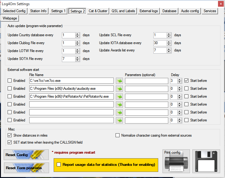

There is provision for starting external programs already included in Log4OM - Options/settings 2 with start before and delay choices!!!!!!
Screenshot 2015-12-07 12.28.33.png (64.28 KiB) Viewed 2925 times
