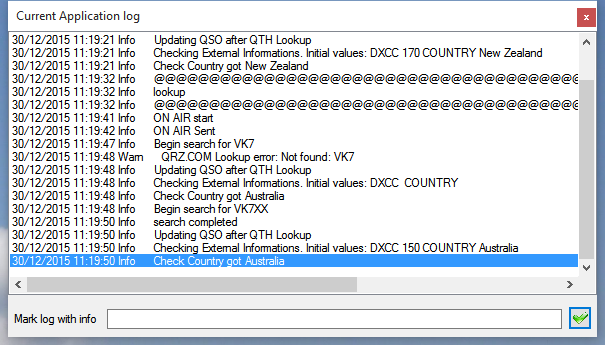

Re: User manual info and 'Realtime Log'
VK7XX wrote:Actually, how to set it up would be helpful
Just open it an all Log4OM activities will be displayed
If you want to add a note about an action just type it in the field at the bottom and click the green icon now that marker will be added to the list
See below where I have marked 'Lookup' and then added your call for a lookup
Screenshot 2015-12-30 11.20.00.png (28.4 KiB) Viewed 2465 times
