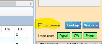

Yes I can confirm there seems to be a bug with the internal browser lookup, I had not noticed because I always use the external browser lookup and I suggest that until this is fixed that you also use the external browser
