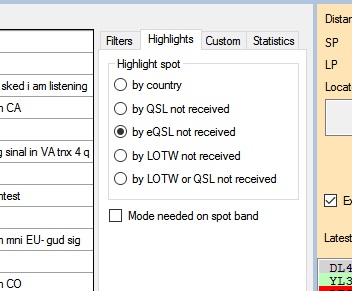

Duane,
A search of the forum will reveal that this feature already exists by combining the 'Highlights' and 'Filters'
Select- Remove worked countries in the filter tab
Now in the highlights tab change 'by Country' to 'By QSL not received' or any other not confirmed situation like eqsl or LOTW etc
Screenshot 2016-01-17 11.59.19.jpg (34.95 KiB) Viewed 1789 times
Now the displayed spots are for spots not confirmed by QSL (or your different selection)
