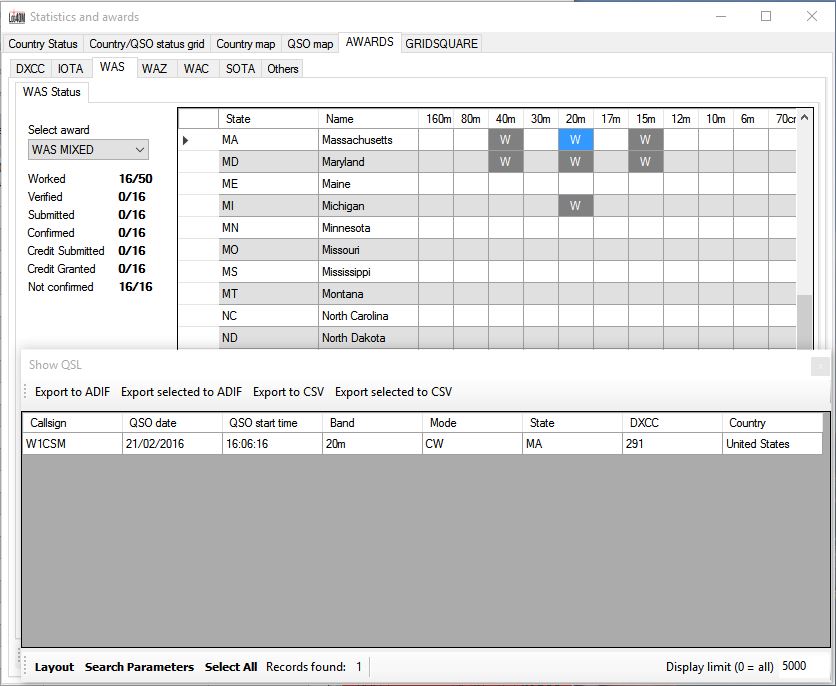

I note that the Wintest ADIF did not contain any country or DXCC number so during the import I checked the box 'Update countries in ADIF' to ensure that the country and DXCC were available for the awards WAS calculation.
Clearly the state means nothing if we don't know what country it is in, but fortunately Log4OM can calculate the country and DXCC from the call prefix.
On opening the Awards/WAS window and selecting 'Mixed' all of your states are displayed as Worked 16/50 and each worked state/band displays the relevant QSO as below so I am rather puzzled!
What version of Log4OM are you using and could you post a screen shot of the 'Not found' message
