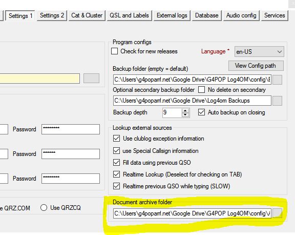

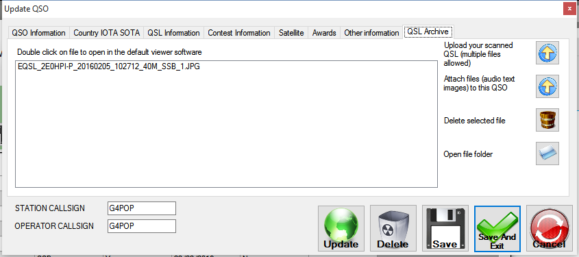

hi in the qsl management when you select to download eqsl which seams to be working were does it store the downloaded images can you help please
best 73s 2e0sia
Posts: 11593
Re: qsl management
Wherever it is set to in the options as below
And accessible on all edit screens as below:
Screenshot 2016-03-04 12.47.09.png (47.22 KiB) Viewed 2622 times
2e0sia
Posts: 16
Joined: 14 Feb 2016, 22:45
Re: qsl management
Post by 2e0sia »
thanks very much i had no path set ty
Re: qsl management
Default is saved in your settings folder.
This field, to the date, is strictly bound to the application. No different folders for different profiles.
