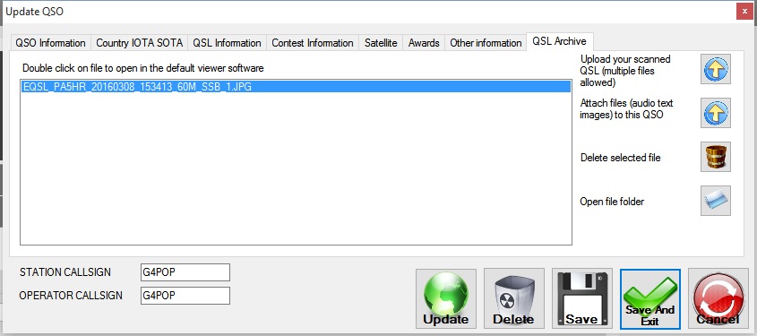

G4DWV - Guy wrote: Is there any way to access the eQSL images from within Log4OM?
Yes in the QSO edit windows
