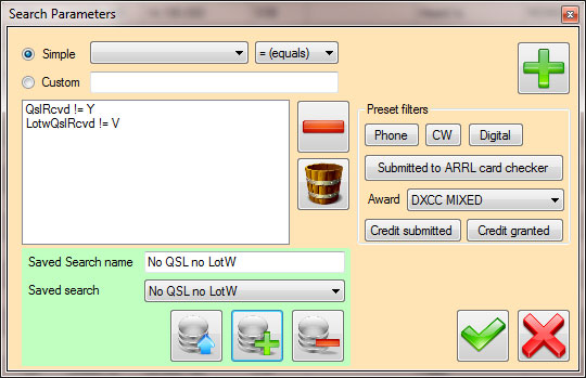

If you need a query for export or just to get a QSO list of those contacts who you have not confirmed via card or LotW, try this. Open QSO Archive, create a search with these parameters - QslRcvd != Y and LotwQslRcvd != V (!= means Not Equal)
Then with those parameters set, click on the Search button at top. You can also save that query for later re-use.
Here is a screenshot of the query:
